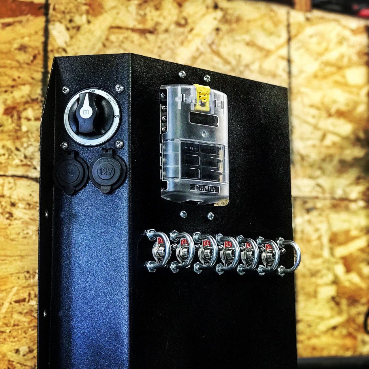

    Custom fabricated rear electrical panel/cover for everything electrical from the cab back

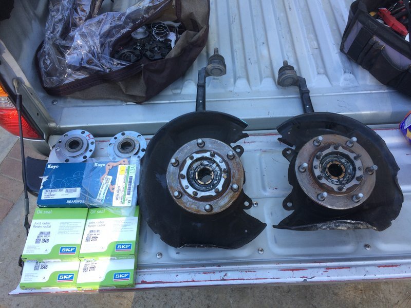

    **update**
    Received the hubs/knuckles today and now I can start cleaning and getting everything ready for install
    Knuckles came off a 98 Tacoma 4x4 v6 auto
    Bearings are Koyo #HCDU5496-6LFT
    Seals are SKF model 27117 x2 and 35418 x2
    Aisin lockouts have been torn apart and cleaned and are ready for rebuild. New gaskets for lockouts Toyota part # 43531-60010

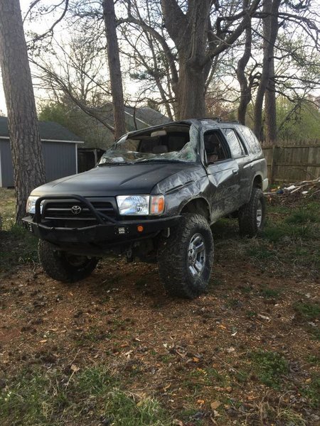

    Found this thread while looking for similar builds. Going to look at a totaled '96 4Runner this weekend for a donor. Looks like a lot of good parts, 3" rough country lift, brand new 33" bfg's and an aftermarket arb-style bumper. Not sure of the bumper manufacturer but should know by the weekend. Overall the guy wants 1750 for the truck as is. I'd say this is a good start for a parts donor. Truck was flipped, still drives just fine with. No damage to drive train or lower half of the vehicle.

    I plan on trying to talk him down a little. He was selling the 4Runner for 1500 without the bumper at first. Was gonna ask $650 for the bumper separately. After I mentioned I was interested in it all he said 1750 would buy it. Here is a pic of the truck. Tires are suppose to be like new, as well as new ball joints and cv axles. Would there be any issues with using ADD over manual hubs? Anything that I may need to know to use as bargaining leverage.IMG_7446.jpg
