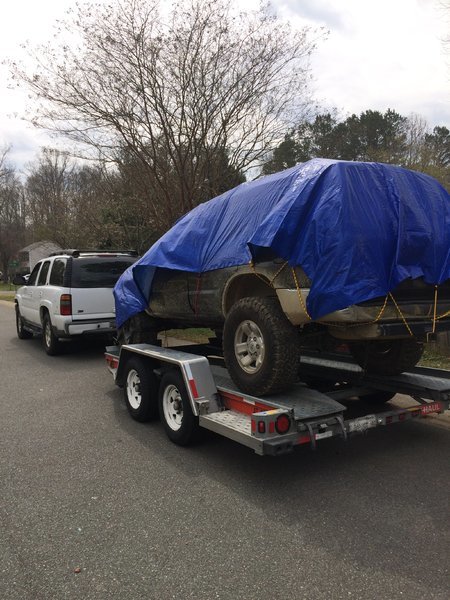

    04 Prerunner soon to be 4x4
    Started tearing the 4Runner down yesterday. I read somewhere before that there would be an issue with the speedo when using this in a 1st gen taco. Not sure what that is yet. Also passenger side cv axle is being a pain to remove from the diff. May need to break out a crowbar

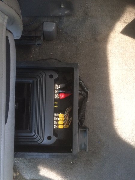

    **update**
    I haven't had the chance to work on the 4x4 system yet but I've made some changes including amp box with fans and switchback leds for the turn signals. If anyone has any questions feel free to hmu

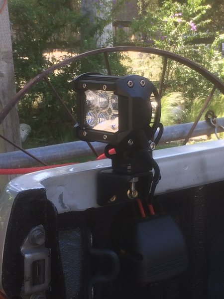

    **update**
    I purchased the front drive shaft and front diff mount brackets from a tw member so we're getting very close. Just waiting to hear back from a tw member/ buddy to see if we can swap front diffs so I won't have to open the clam up. (The diff I have is 3.73 and he has a 4.10) hopefully we can work out a trade.
    Only thing left is going to be cvs and it'll be time for the conversion.
    Made this little bracket for my chase/dust lights. Just need to make the other side.
