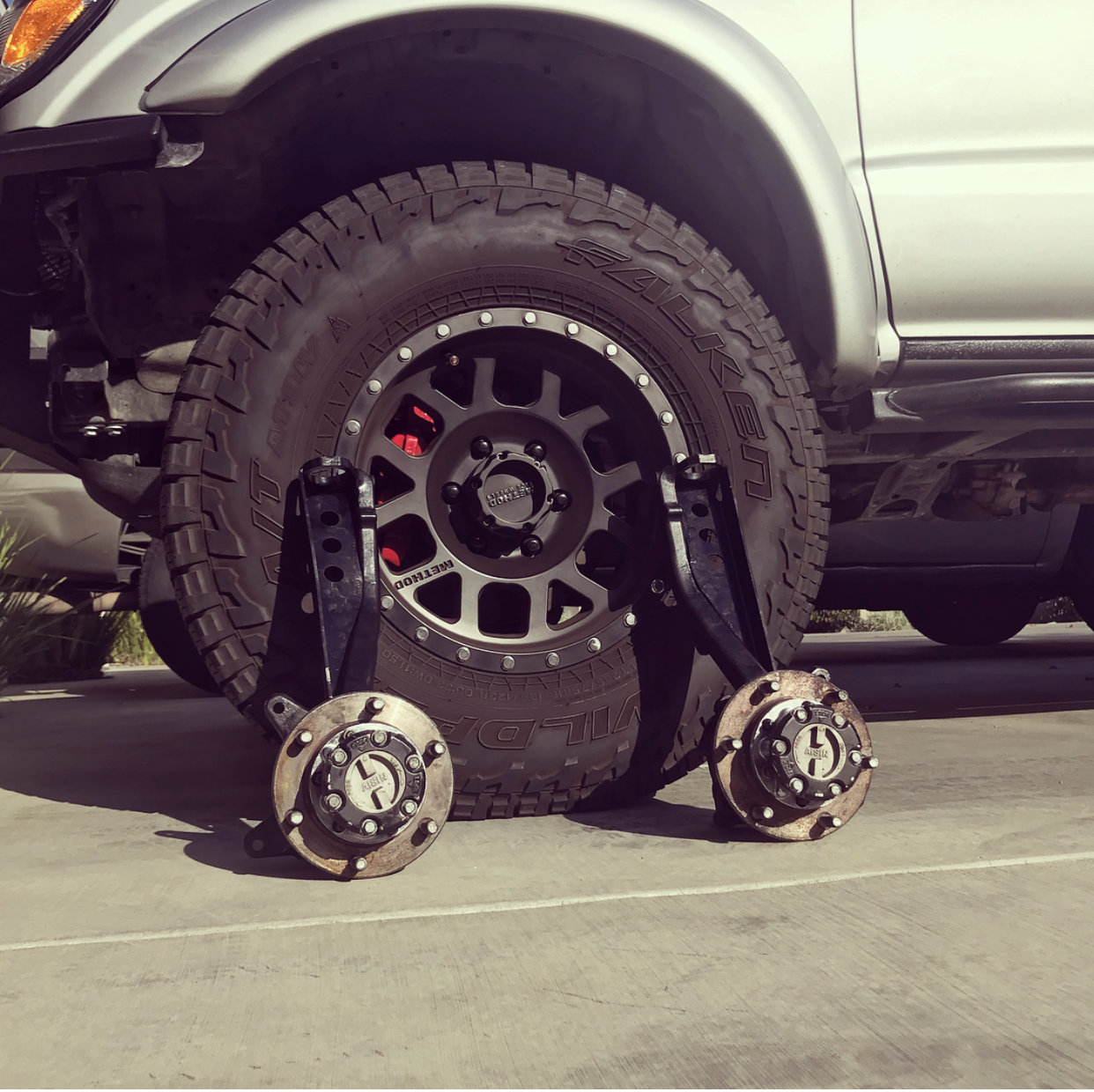

    Getting ready to finish the 4x4 swap everyone!! I had a friend who has a 04 double cab give me a set of 6 lug spindles so I’m having my fab guy weld total chaos spindle gussets on them and I’m going to paint them so they will be fresh and ready for new bearings and hubs. My plan is to have the new bearings and hubs pressed in on Monday and finish my swap by the weekend. I’ll keep you guys posted and I’ll add pictures as I go.

    Next step checked off the list
    New koyo bearings and seals. Freshly rebuilt Asian lockout. Total chaos gussets. Now I just need to clean off some surface rust, chase the wheel studs/lockout studs, and some paint touch up and we’re ready to go! The LBJs will also be replaced when I do the swap with 555s. She’ll be fresh and ready for Jeanette and I to do some exploring! Can’t wait..

    We did it! 4wd swap comeplete! I’ll have some pictures in the next few days. Everything went surpisingly well. Had a few hicups but nothing that we couldn’t over come.
    I can’t wait to go test it out :mudding:

    For sure dude I’m down. I’m going to test everything and making sure nothing is leaking and everything is perfect then we’re gonna hit some dirt! Ah man this is so cool. I woke up this morning and locked the hubs and ran the transfer case through everything. It was so smooth. No vibrations, noises, grinding, anything. I was really happy. I need to touch up the lock out dials cause i kept all the swap stuff in a box and it got scratched up. But other than that I think she’s ready.
