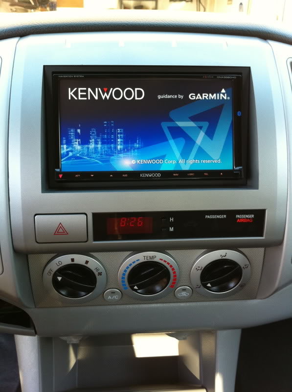

    UI is typical Garmin. Seems the same as our old Garmin unit from years ago. Fairly intuitive to me. The only problem I've had was figuring out how to change the volume of the turn by turn directions. Finally realized that if I change the volume on the unit when she's talking, it changes her voice. Not sure if there's another way.
    Lag might me a second or so. I don't really notice. The screen resolution is so good, I'm usually admiring that...
    My parents live in a fairly rural area. It guided me to their house accurately - except took me to the place next door. So there it was off a bit, but not much. I haven't had it miss the mark otherwise.

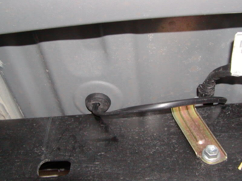

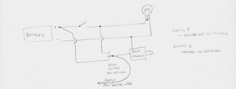

    Nice. I have installed my double din dash in n now I'm working on installing the rear view camera. I am having trouble of finding the drain plug to put the wire through to hook up to the gate handle.
    I have a 2005 tacoma access cab 6 spd manual. Any ideas of how I can wire it to the reverse wire with model? Or is it easier by doing a switch so I can look at it anytime?

    I wired it so it came on in Reverse and switched for anytime on.
