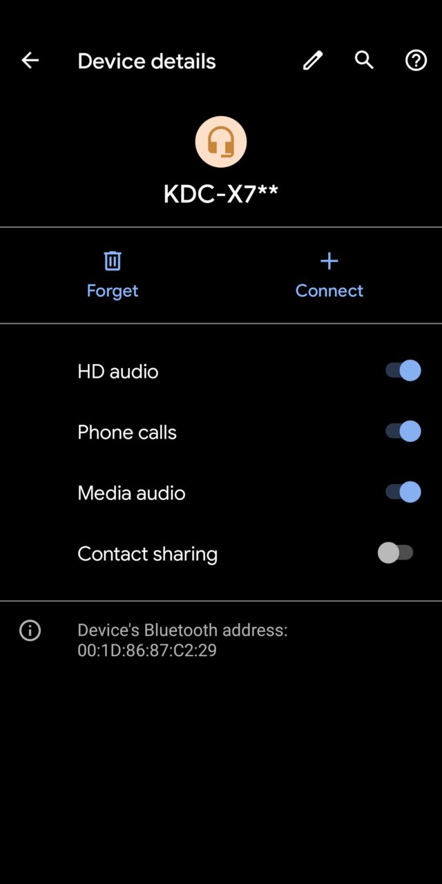

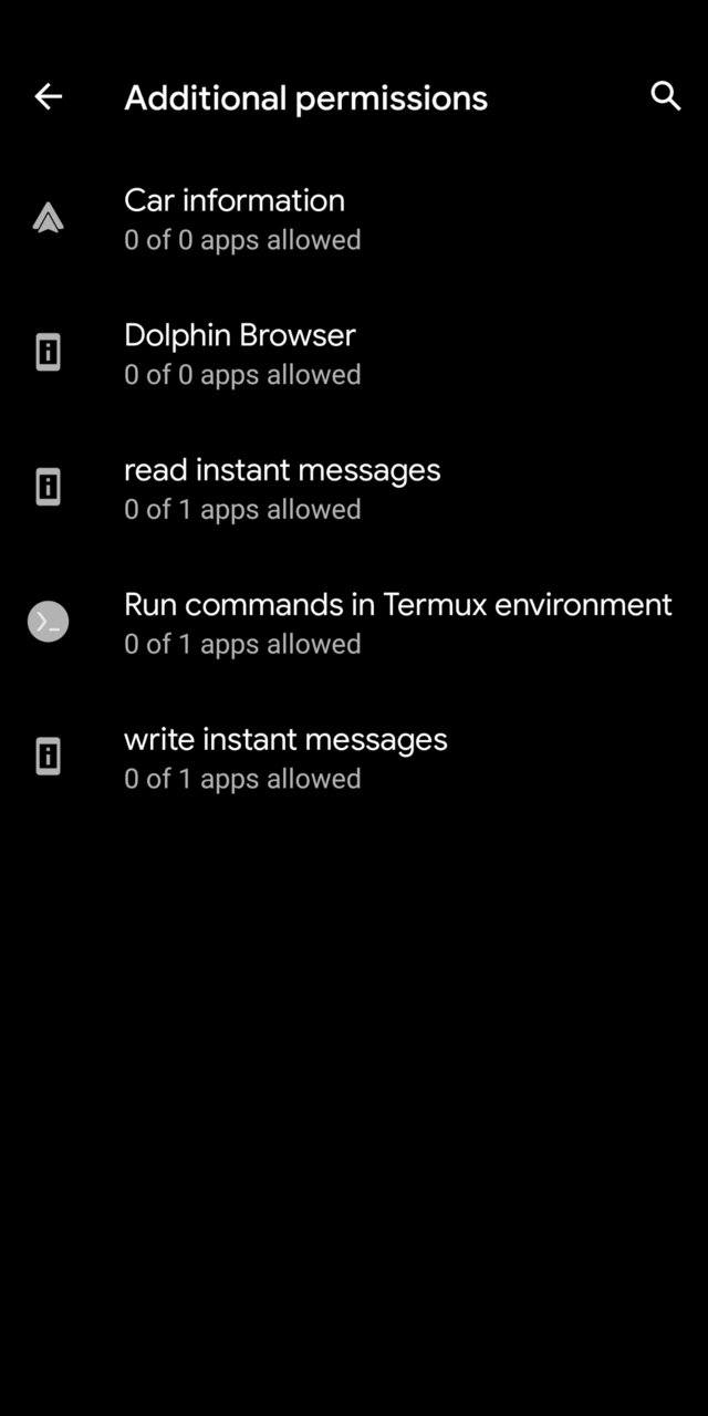

    Did you give the radio permission to access contacts and messages? Open the seeing for that connection on the phone and make sure everything is checked.
    As you can see, I don't.
    The first screenshot is for the radio bluetooth connection. The 2nd is in settings/privacy/permissions. This is a Pixel 2XL, so you're screens may look different.
    Good luck

    I was just in the truck going through the stuff Larzzzz sent screenshots of when my wife texted me. That text popped up and gave me an audible notification. We sent a number of test texts. I still don't get a visual notification unless I am on an AA screen, but I will get an audible notification. Voice to text works pretty well also. I changed absolutely nothing in any setting. All I did was open the bluetooth settings on the phone for the radio connection.
    I am at a loss as to why it all of a sudden started working, but I am definitely not going to complain about it. I do still wonder why I have to be fully connected to AA for any texts to come through. I don't understand why just being connected via bluetooth doesn't suffice.
