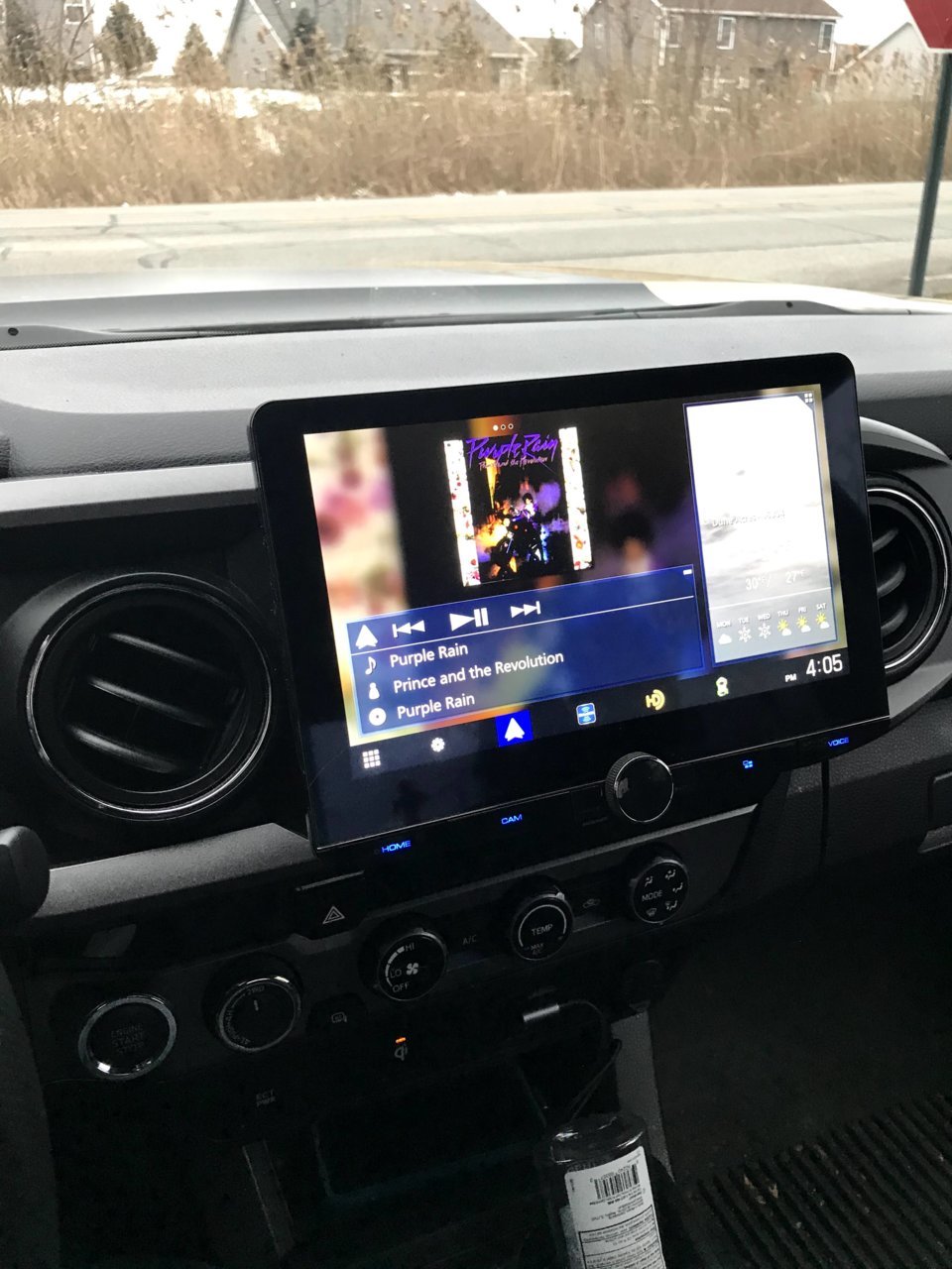

    I installed the unit back in December. I haven't installed a car stereo since high school, >30 years ago. I was going to use Crutchfield's wire service, but it often isn't available when they are busy. So, I spent several hours doing all the wiring at my kitchen island (my garage isn't heated and it was pretty cold in northern Indiana in December). I opted to use the adapters for use with the existing GPS and satellite antennas. I didn't want any additional clutter around the truck.
    When I finally went out to install it in the truck, it was fairly simple...just plug and play at the stage. I will say that it is a little bit of a pain, getting it installed just right (with the screen adjustments). This is only bothersome because, with the screen being so large, you need to attach/reattach it each time you are checking fitment... you can't fit the dash molding around it.
    I have the OEM USB plug working, I wired the microphone to replace the OEM one (the cord was just barely long enough to reach). Wired/wireless android auto is working flawlessly. I tested the wireless screen mirroring out only once, but it seems to work flawlessly as well. The thing seemed a little too big when I first installed it, but I really have come to love it. All and all, I can't find much to complain about with the unit...except for the little weather widget's not regularly connecting (but I don't use it much anyways...it just kind of looks pretty when it does work).

    Looks really good! Did you wind up with the screen in the factory setting or did you extend it out? I decided to also install a dash cam with mine, and I think I’ll nix the HDMI cable as I’ll probably never use it.

    Did you put the mic in the factory location? If so, did you drop the headliner a bit in the front to run the mic, or were you able to do it without doing that?

    I did a little tweaking. If I recall, I may have kept the depth where it was (I wanted as close to the dash as possible) and may have shifted it vertically a bit to make room for seeing hazard switch, etc on the dash.

    Yes, I did use the factory mic location. Removing the A pillar, I ran it along the airbags and such and was able to work it under the headliner without dropping it. I dropped the crawl control access panel and from there I tugged alternately at the mic cable from the A pillar and crawl control to kind of work it deeper into the headliner, further away from the windshield. I left the OEM mic in the headliner, for reinstalling the OEM stereo if I choose to later. I was able to fabricate (using the term very loosely) a bracket that seems to hold the new mic in the OEM location very nicely. Then I added some sound deadening behind it. I think, from all accounts, it is better than the OEM mic.
