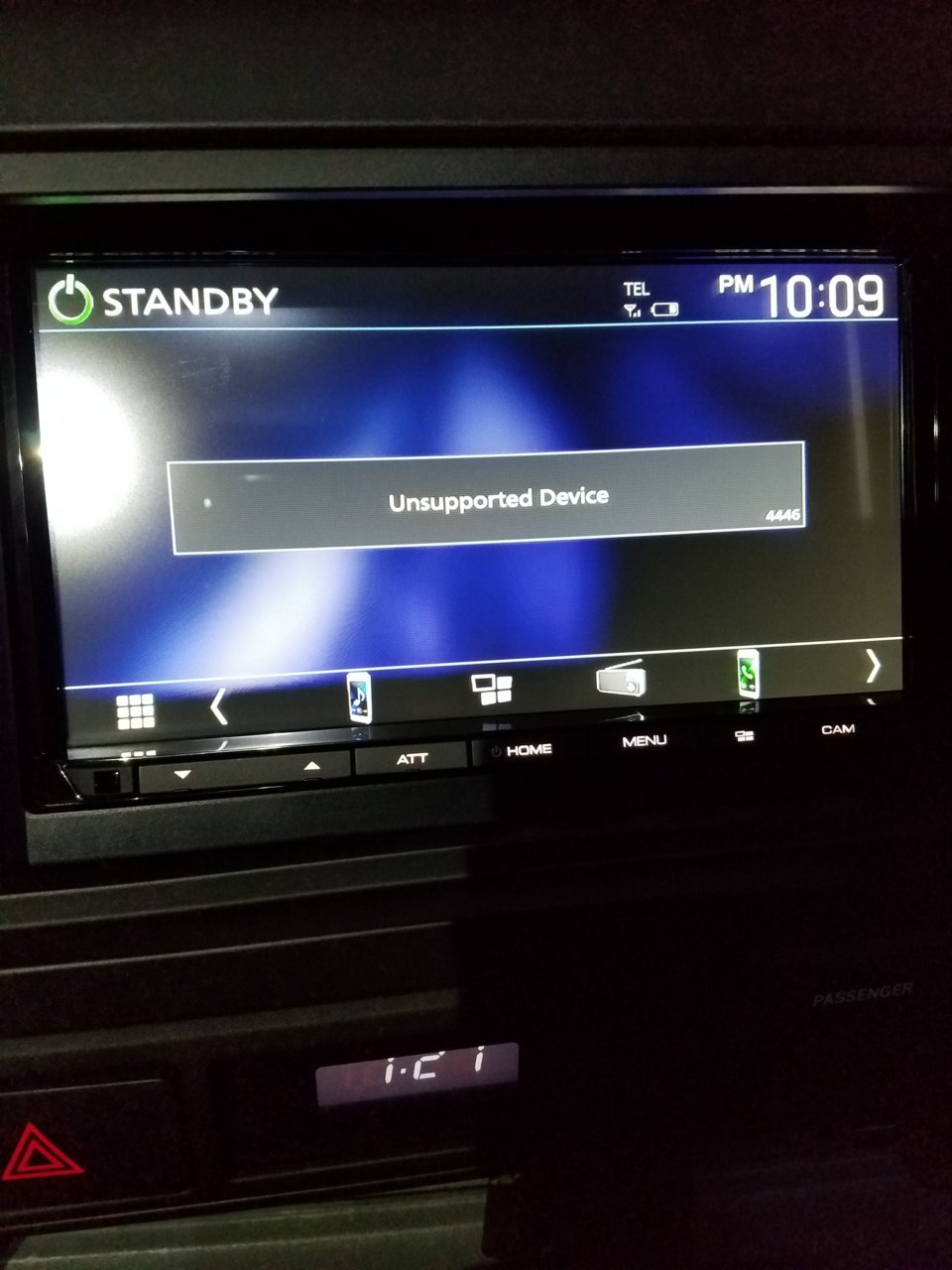

    Just put a kenwood dmx7706s and maestro rr in yesterday. Sounds way better and all that junk.
    -Phone only charges off usb port
    -HU says unsupported device 4446 (galaxy s7+wife's s9) tried 4 different cable out of the Factory USB port with adapter, and straight off the USB out of the unit
    -Ipod mini also says unsupported device
    -but.......thumb drive with 1GB of music works no problem?
    Wtf? I would really like it to work what am I doing wrong here ?

    Ok. S9 failed too. Android auto set up and connected. Icon popped up and then......3 seconds later. Crashed and disconnected.
    Worthless. I guess I give up. At least the stereo sounds better and I cant play CDs anymore ....

    This is all I'm getting with my phone. Disappointed
