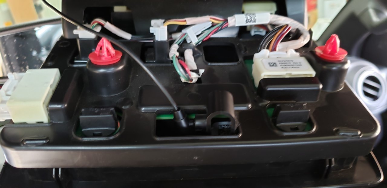

    I took the mounting bracket off The mic and put it in at an angle. There’s enough clearance above it doesn’t need to be fully in there. Then I took a piece of foam and hollowed it out a bit to push in the top so the mic would stay down in place.

    I placed the kenwood mic in the same place as the factory mic. Worked perfect

    I took off the bracket and hot glued it in place so it didn't rattle. There's a post somewhere in this thread....

    I’m about to do this install and have two questions for you. Could you post a picture of exactly how / where you mounted the microphone? Could you explain why the break bypass is important in this install?

    I could get a pic but probably not until this weekend. It's about 20 and snowing the next 3 days so the idea of going out and pulling my overhead down doesn't sound fun! I have a different vehicle I drive to work so don't usually have the truck with me.
    If you look up at @ratcityrain picture a few posts above, mine looks pretty similar except I took the microphone off of the mount. I then just took a piece of aquarium filter foam and cut it to a square that fit the cutout and pushed it in on top of the mic. Figured that would keep it in place and eliminate potential road/wind noise from the roof.

    I'm just using double stick tape to hold it in there and haven't had any issues with clarity or it moving around, plus it's out of sight which is what I mostly wanted.

    Thanks. I scrolled up and saw the photo. I’ll give this a shot as I too want the mic out of the way.

    Please pardon my ignorance but I fail to see a mic in your pic. In my Taco, the factory mic is in the headliner. I also failed to see any pics of the headliner in this thread. Did I miss them or is your factory mic in a different location from mine?

    In the picture above, you are looking at the overhead console removed from the headliner. The long black wire going into the little cubby is the OEM mic spot in sport and off-road models. I dont know about other models

    Thanks. In mine the mic is directly in front of me in the headline away from the console.

    mine is there as well but the old spot in the center overhead console is still there and works well as a place for an aftermarket mic.
