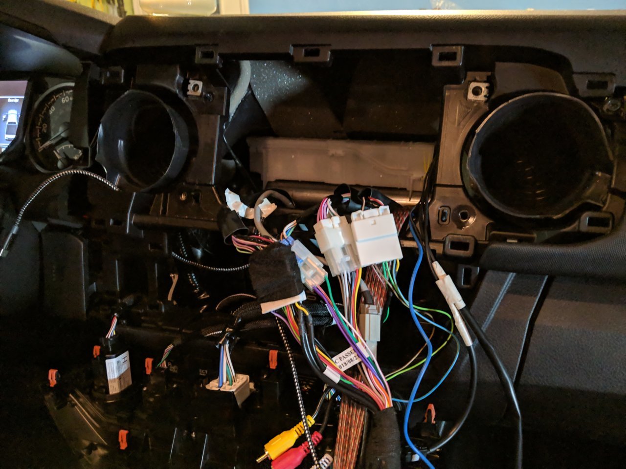

    I got a good amount done today. I took the opportunity to teach my son how to rip apart a car and wire, but I did not get everything finished.
    Also, the Scosche TA2122B is not the right size. Lol.
    This picture reminds me of the puking pumpkin pictures:
    Look, the screen floats
    Anyway, I still have a list of stuff to do.
    Run mic for Bluetooth
    Plug into amp
    Tune
    Plug in wires
    Put sub/amp back in it's spot
    Put back seats back in
    I've function checked and we are good to go, but I have another dash kit on the way. It'll get here Sunday.

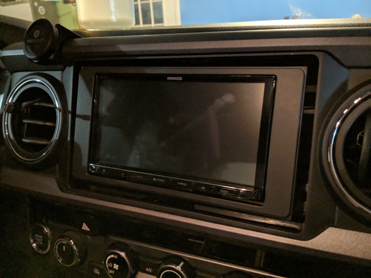

    OK, all wrapped up, and with the right dash kit!
    A few items of note/first impressions:
    1. Holy shit what a difference in sound. The Morels I have in the truck were nice with the OEM head unit, but now they are incredible. The clarity at high volume is astounding.
    2. I don't like WebLink. At all.
    3. I have a Pixel 2, so my phone hooks up flawlessly to wireless Android Auto. I put my phone on the plug to get the battery charged and to have wired AA.
    4. The back up camera resolution is not bad, but not as good as the OEM head unit
    5. Pre-Loaded equalizer settings!
    6. For some reason on the gauges I get no fuel reading:
    7. The Apple Music iPod over airplay is very nice. The sound quality is better than I expected it would be.
    8. The iPod and USB are labeled just that, the names don't change based on what the item says it is (my USB came up as "Catalogs" on the OEM head unit, and the iPod as "Moar Muzak")
    9. Max volume before distortion was 37 on the Kenwood. That is where I tuned the amp at, 37. I turn it up to 30 and my hair is vibrating. VIBRATING. The clarity is amazing.
    10. Turning the volume up, you can press and hold until it gets to 15. After 15 you have to press the up button for every notch higher you want to go. Wonder if there is something in the settings to change that.
    11. Do not run Kenwood Link/WebLink at the same time as running AA. Funky shit happens.
    12. If running AA, make sure the phone you are using is utilizing the GRAY USB. I know the manual says you can use either, but I call bull shit. I had my phone plugged into the black USB, and the only way it would link up to the head unit was if I downloaded Kenwood link/connect or whatever. I switched USB, and all was right; phone went right to AA.
    I tuned the amp using 40hz @-5dB for the sub and 1000khz @-5dB. The Steve Meade Designs DD-1 is the most amazingly simple tuning tool. The last few amps I have set up, I used an oscilloscope, and they can be a pain in the ass. The DD-1 made this the easiest tuning ever, and is dead nuts on.
    When I ran the first test song (Umphries McGee's Miami Virtue - lots of bass and full range), I was giddy. Like really giddy. Like way giddier than with the OEM unit's sound.
    All in all, so far so good. Audio books have good sound, as well as the USB and iPod. Waze looks great on the screen:
