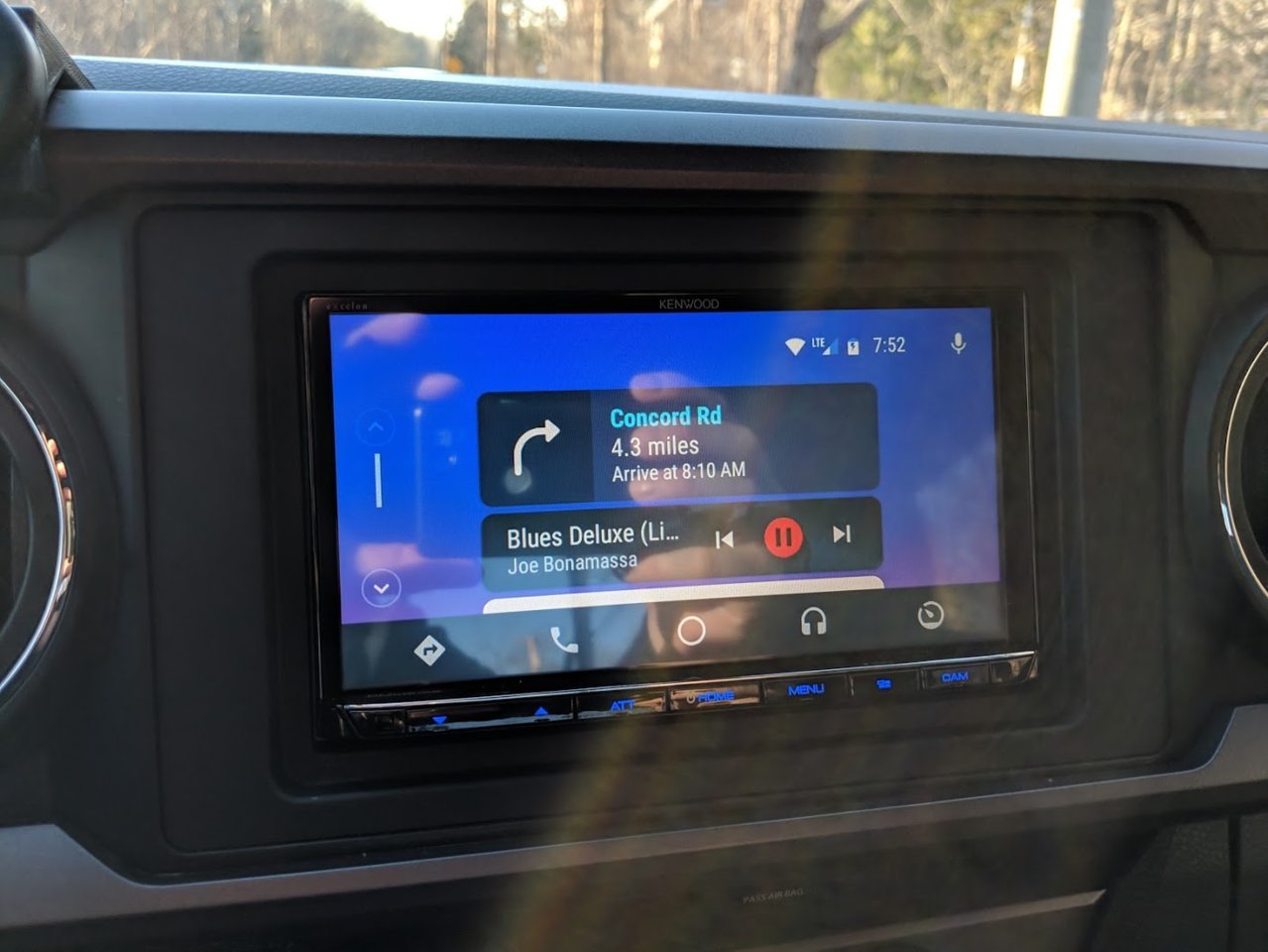

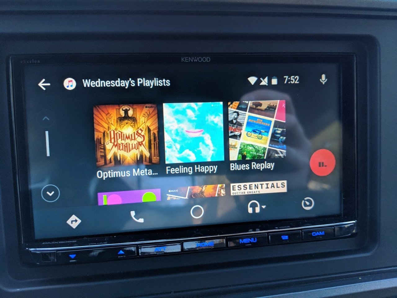

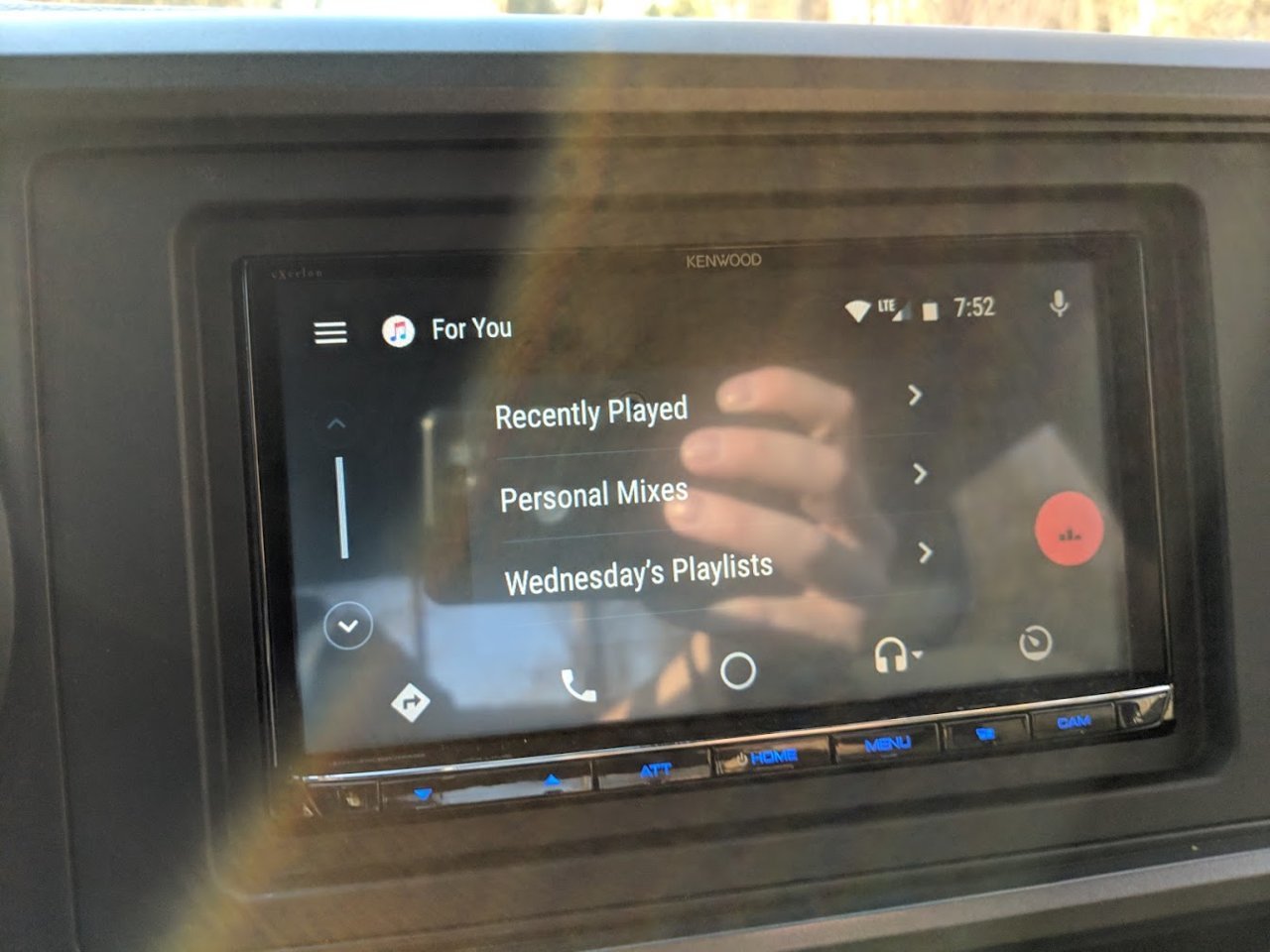

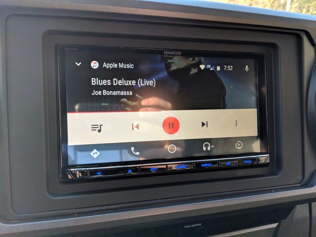

    Apple Music via wireless/wired Android Auto:
    Let me again preface this by saying I understand that not all Android phones work with Android Auto (AA), in fact: I believe only Google Phones such as the old Nexus and the Pixel series phones are the only reliably connecting phones via AA. I have a Pixel 2, and have zero issues connecting to AA.
    Also let me just say, I like Apple Music. The only reason I switched to an Android phone this time around is when I found out you could use Apple Music on Android phones now. I have a family subscription to Apple Music, and believe me, my family uses it like a hooker gets used during fleet week in NYC. We get our money's worth. I don't care to learn Spotify or Slacker, and I can't stand Pandora.
    Shopping for a head unit is a hard task quite frankly. You can do all sorts of research via Crutchfield, SonicElectronix, Amazon, and all other corners of the internet, but unless you can actually touch/play/screw with the particular units you are interested in, you'll never really know what you are in for. This was especially true for me, as I had certain criteria for what I wanted, and could not find answers anywhere. Having the ability to go to a Kenwood Authorized dealer, that had a wall of head units set up, gave me the ability to get my questions answered.
    Get to the point Ron:
    One of my bigger questions was in regards to Apple Music while utilizing AA (wired or wireless). Would Apple Music even show up as a selection in the music? The answer was yes. It works very well via wireless/wired AA, and sounds great. I had been using an iPhone 6 with the SIM card removed set up as an iPod in one of the USB jacks (the black one, as the gray is for AA), and that has been working great for me, but sometimes I want to hear what Apple Music has for a play list for me. Lately it's been The Blues. Today it was Motley Crue (I don't have very much Crue).
    All of these pictures were taken while running AA wireless.
    From the AA home screen:
    Someone had mentioned that the AA UI looked like it was designed by a 12 year old. I'm a pretty simple guy, so I don't mind the simple UI

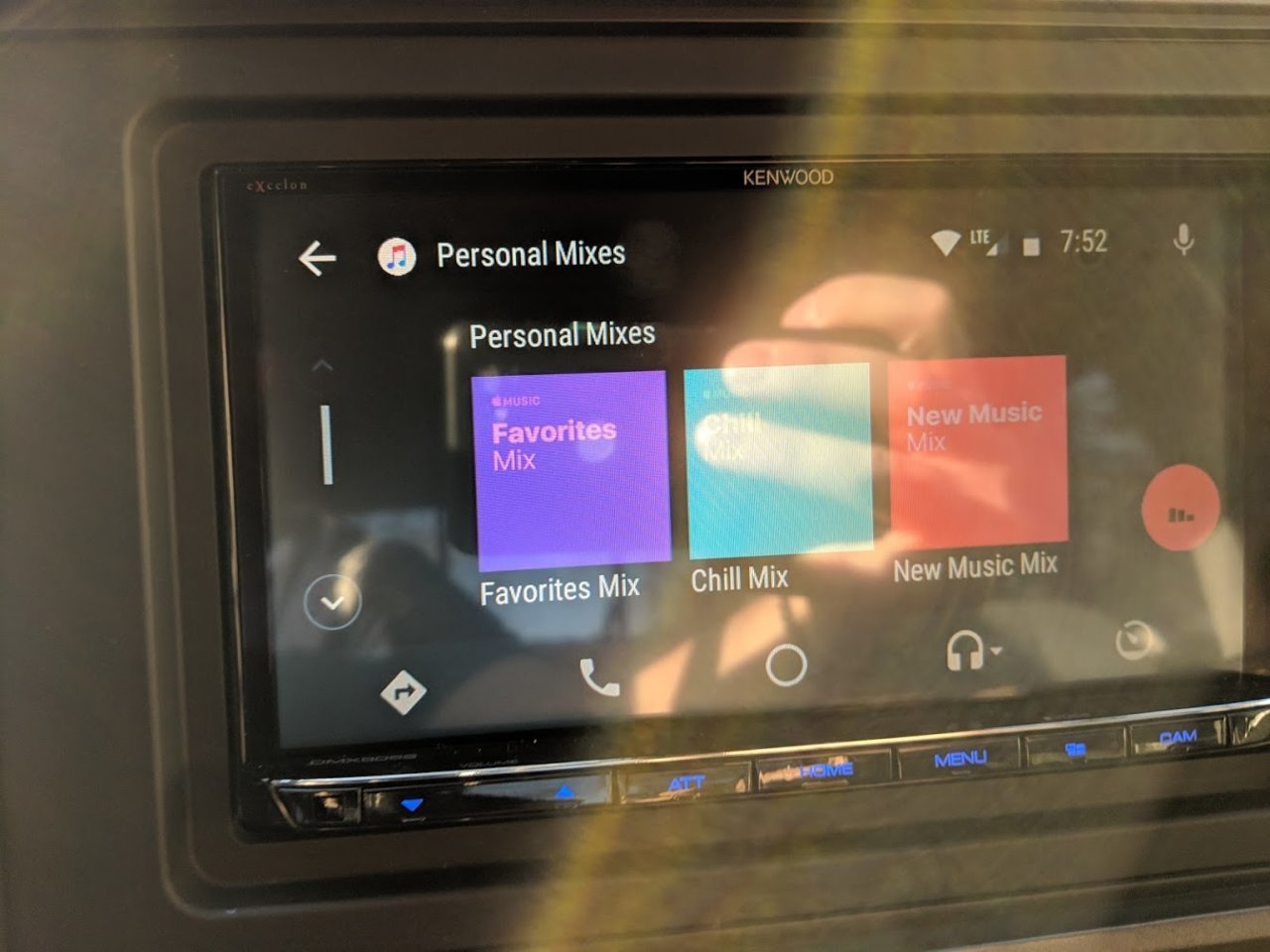

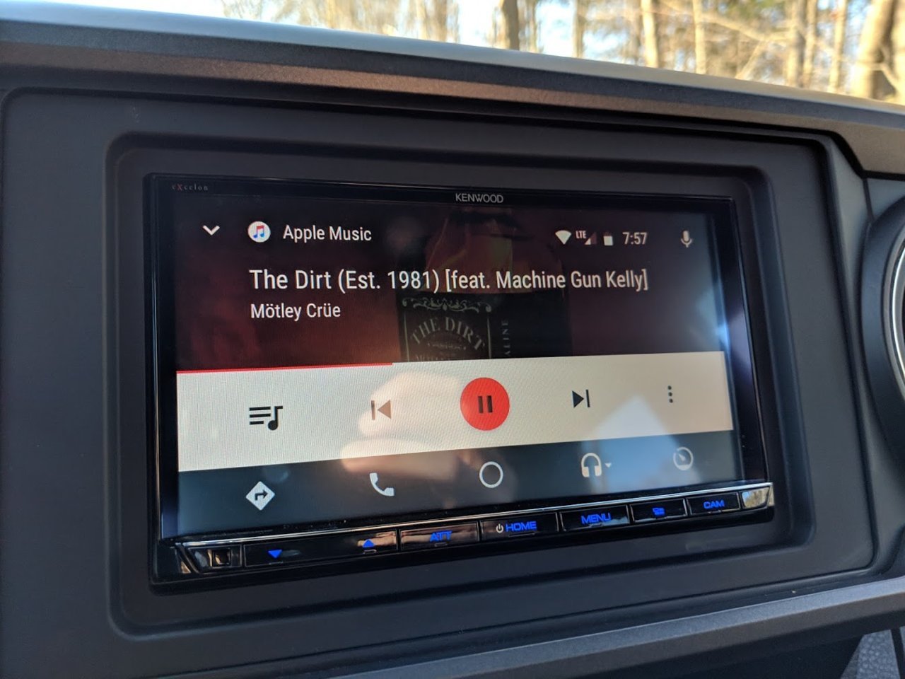

    How now playing music shows up in AA for Apple Music:
    Finding music:
    Crue:
    The UI for Apple Music is easy enough for me to maneuver around.
    You can see the WiFi symbol in the top right info section of the screens. That is how my phone links up wirelessly to AA. Generally speaking, I let my phone hook up to the wireless, and once it is connected, I plug in to the USB as well (more for charging than anything else). The red circle over in the middle left of the screen in some of the pictures takes you to "Now Playing" screen when You press it.

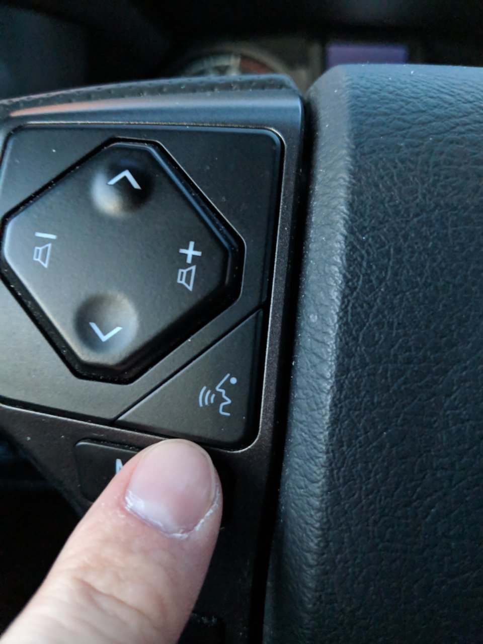

    Feature:
    This button:
    Activates "OK Google". Which is really cool and never used the function on my phone before. Also, I set up my phone for voice prompt "OK Google", and that works too!

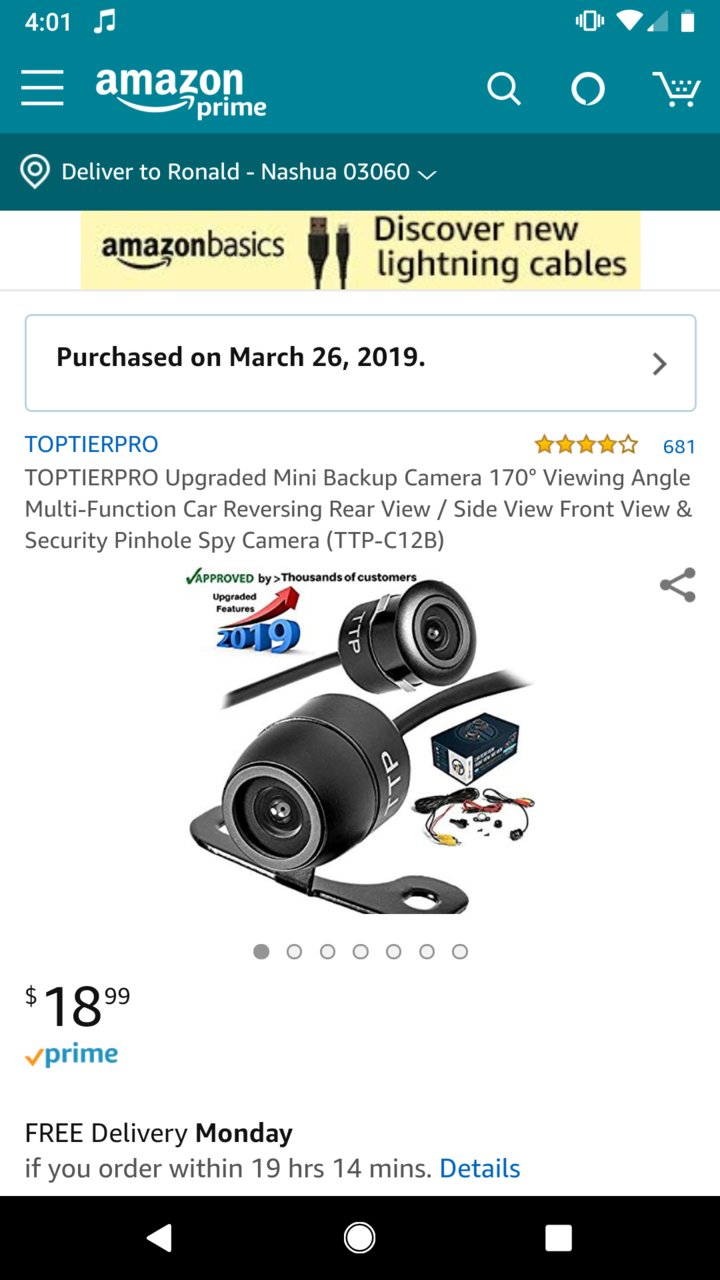

    Today I finished up installing a front view camera. I got a $18.99 special from Amazon
    Install was fairly simple after some typical hand wringing by me. Details of how I mounted it, etc are in my build thread.
    Anyway, now when you hit CAM button on head unit, the front cam comes up
    Long press screen and it switches to back up camera
    Pretty slick. It also auto turns on forward camera when I'm doing like 1 or 2 mph.

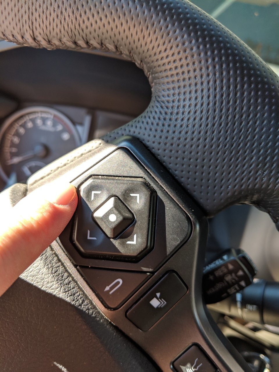

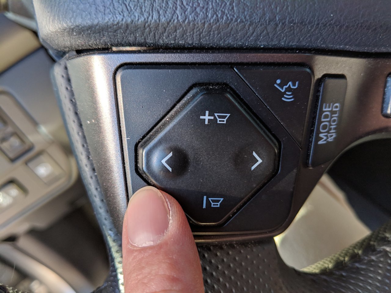

    were you able to get the up/down buttons on the steering wheel working?

    Or these:

    the first one, the stereo function (track up/track down)buttons

    Volume works as normal
    the up/down buttons on that same pad do nothing for audio. The up button changes the home screen (there are 5 home screens), and that is it. Nothing from the down button that I have found yet.

    the other up/down changes the song, but you have to be on the audio screen on the console.
