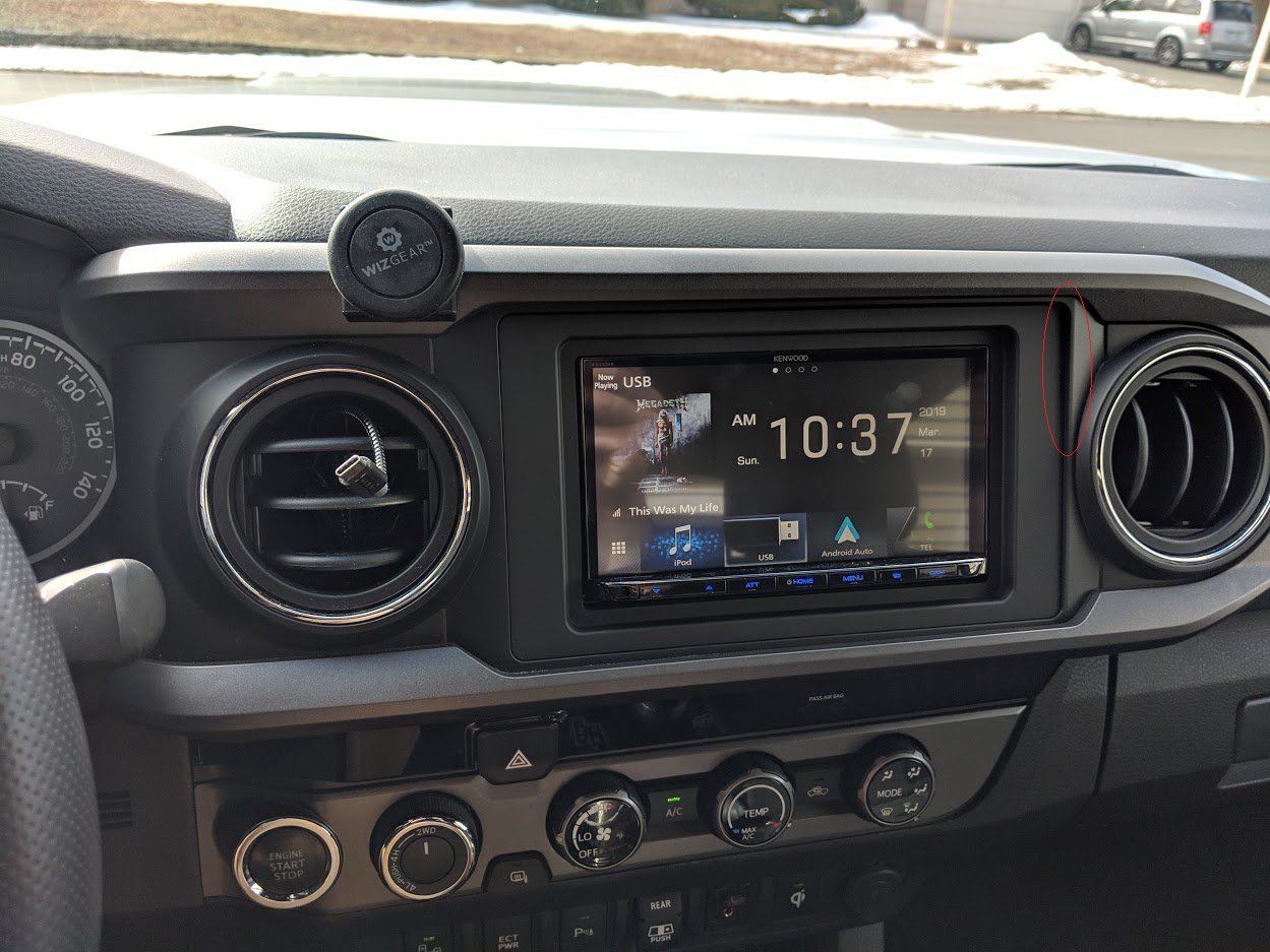

    Im about to show you something, that if you havent seen already, you wont be able to unsee...
    Looks like the dash kit has this issue, I have it on mine and have seen it once already elsewhere. I'm going to pick up some small washers to hopefully address this.
  12. May 21, 2019 at 8:32 AM

  13. May 21, 2019 at 8:34 AM
    #93
    elduder
    elduder Well-Known Member
    Oct 15, 2015
    #166771
    1,858
    Van WA
    2019 Voodoo Blue Tundra TRD Pro
    If you havent seen @dlo13 build page, check it out, nice little audio setup mentioned. We should petition to get him post pictures of it.

  16. May 21, 2019 at 11:04 AM
    #96
    rhallmcp
    rhallmcp Well-Known Member
    Sep 29, 2015
    #165466
    148
    Upstate NY
    2018 Trd Pro
    I had to do the same thing a few times to get mine aligned correctly? and i ended up having to use much longer bolts too.
    elduder[QUOTED] likes this.
  17. May 21, 2019 at 5:38 PM
    #97
    elduder
    Oct 15, 2015
    #166771
    1,858
    Van WA
    Good to know, I will plan ahead then to save a second trip.
