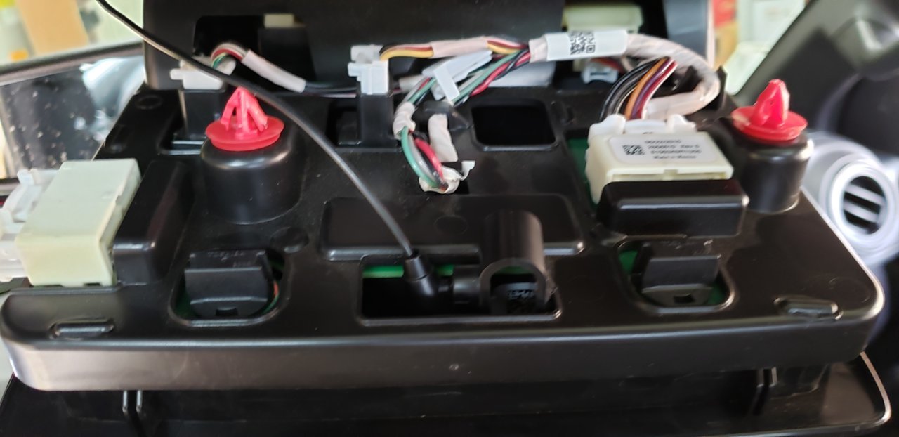

    So I worked on more today and I was able to get the radio to work - yay. There is a white connector from the factory harness that you plug into the white connector with the antenna extension and blue cable. Here is what it looks like
    I also moved the mic to where the factory mic is. There is a gray connector that has the mic built into it that I removed from the upper console and then stuck the new mic there. I did some test calls and it sounds good and now I don't have to look at it anywhere. We'll see if it gives me any issues later, but this is what it looks like installed
