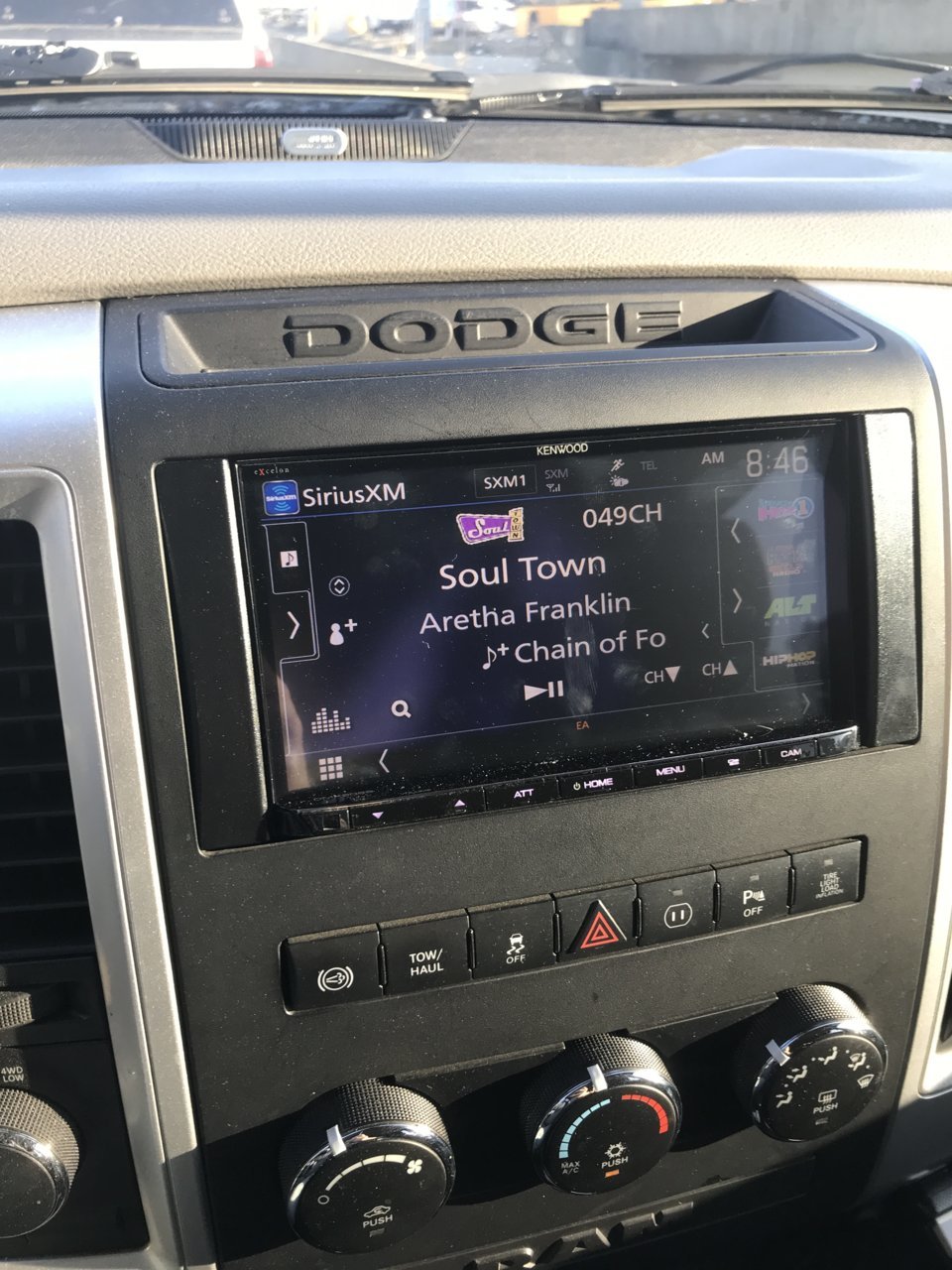

    So I have the deck in my old truck and now being installed into the Taco I just bought. The apple play is great, the android stuff not so much. There are some weird issues like music playing over calls, I’ve had to reset it a few times. It’s the dmx905s. Over all I’m very happy with it
    System will be done weds/Thursday. I can’t wait. It’s nice to pay and be done with it, I installed for almost 15 years lol
