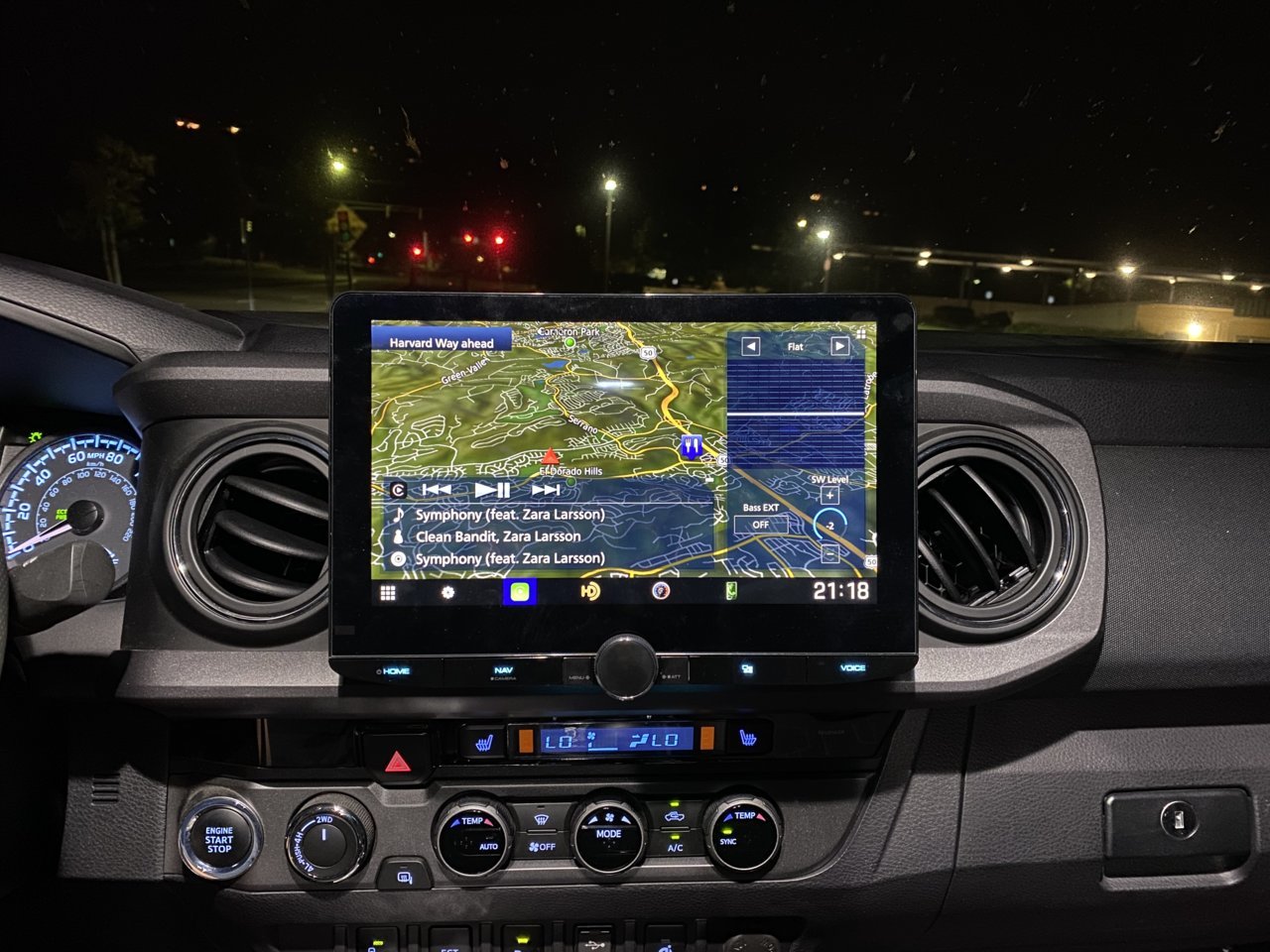

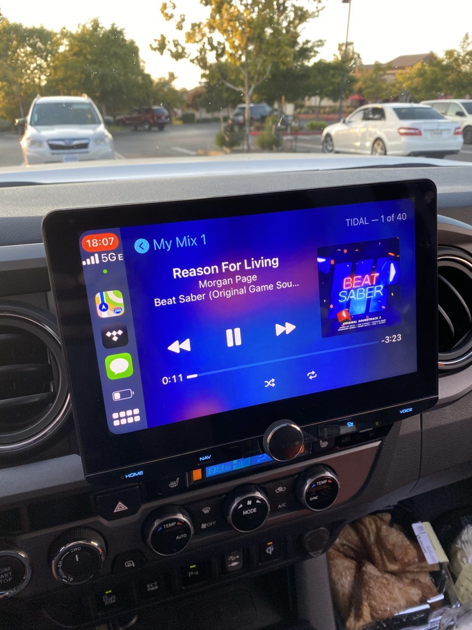

    Shop got these in last week. HAD to hook it up. It’s amazing!!
    The quick specs:
    AMAZING 10.1” HD screen
    Garmin Nav w 3 year updates
    Wireless Carplay/Android Auto
    Only one USB :(
    Hi-res audio BT/HD radio
    5v pre-out
    idatalink maestro RR (since I had one in a previous vehicle) to retain all OEM functionality
    it’s been in my ride a few days now and final verdict: it’s not for everyone, but it is for me!

    Yeah, the floating style isn't everyone's cup of tea, but I wanted to show everyone there are other options out there!

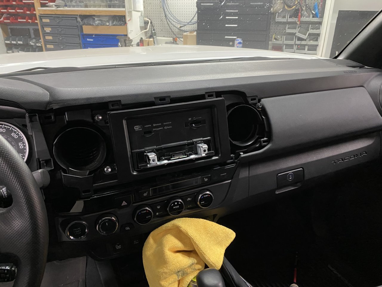

    I'm looking at the DMX1057XR for my 2019 but not sure about the floating display. If you've still got this in your truck or have the pictures would you mind dropping a couple more, maybe driver's perspective and a side shot? Thanks!
  10. Feb 16, 2021 at 7:10 PM
    mjc251
    mjc251 [OP] Well-Known Member
    Apr 12, 2017
    #216040
    324
    Mark
    2022 TRD Off-Road DCSB
    Here’s a shot mid install, you can maybe get an idea of how far it sticks out. I’d say it’s maybe an inch past the outer bezel, and it has to stick out that far because of the adjusting mechanism behind it. I’m out of town the next couple of weeks otherwise I’d take a side shot for you.
