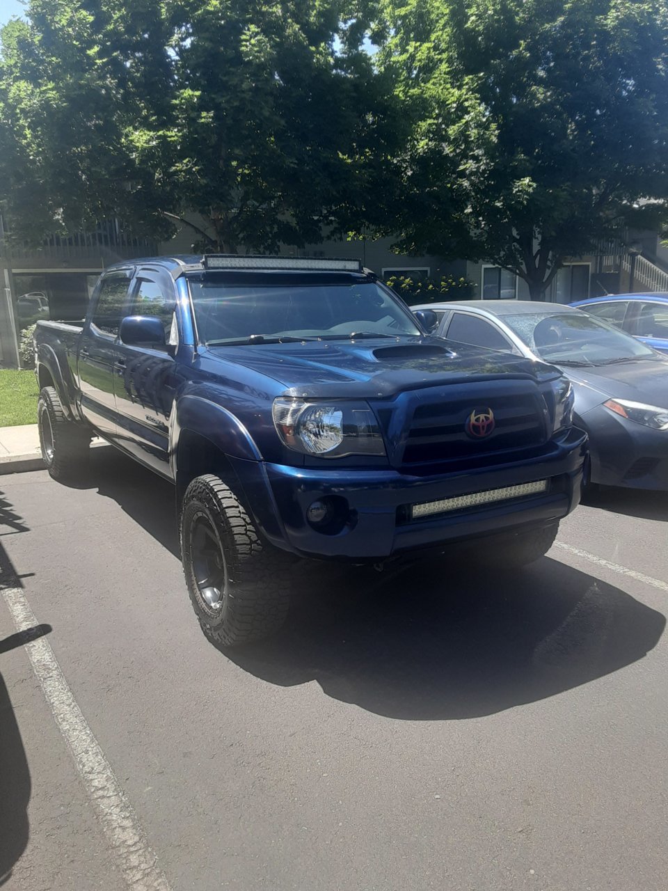

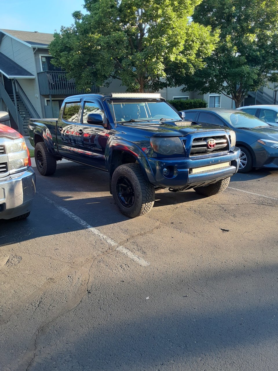

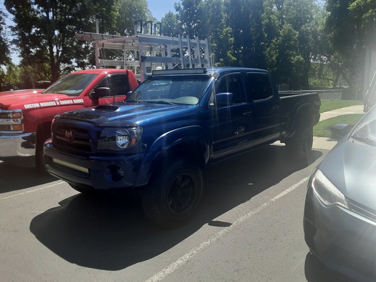

    Hey everyone!
    I am Nate And I have been patiently waiting to post a thread here! Jennjenn (my sister) let her baby go home with me and I couldn't be more excited to have it! Cant thank you enough for trusting me with it!
    I have ordered several parts already, and decided to tinker around with it today as some parts are arriving
    I got the headlight housing replaced this morning. jenn told me there was visibility problems before I purchased, and after using the truck over memorial weekend, that was no joke. Got rid of the blacked out lens, and went with black housing clear lens.

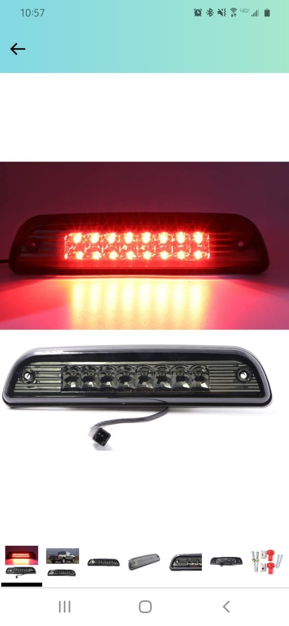

    Next thing I will do is third brake light lens. It's a black LED conversion and was wondering if anyone can give me some pointers on wiring since instructions didnt come with it. I know I'm gonna have to take the headliner off too so whatever will help me not break anything would be much appreciated!
    (Sorry for the potato pics, this phone is garbage)

    What brand is the brake light?

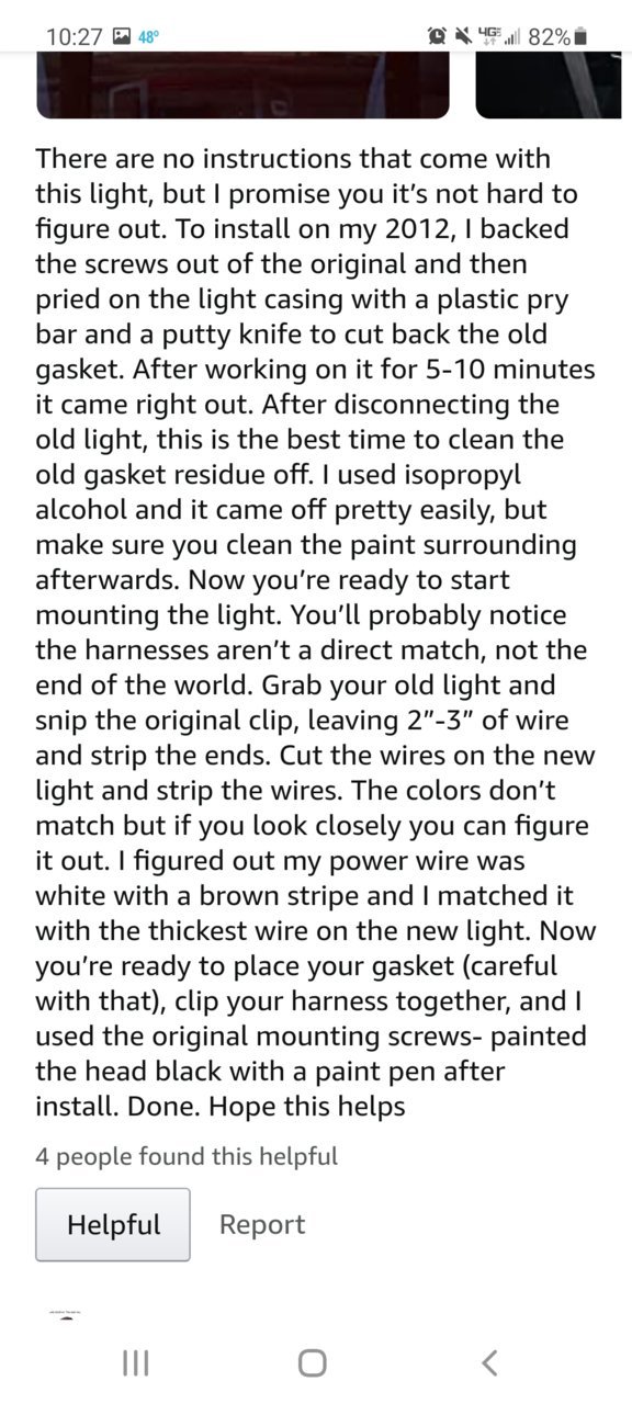

    Welcome! Found this in a review looks like it will help
