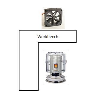

    @captainh00k
    If you can safely set it under something, so the heat is absorbed, then fed back as radiant and spread by a fan, it will help. This absorbs some heat down low and radiates it more slowly than just the heater itself.
    Ceiling fan is definitely a good idea.
