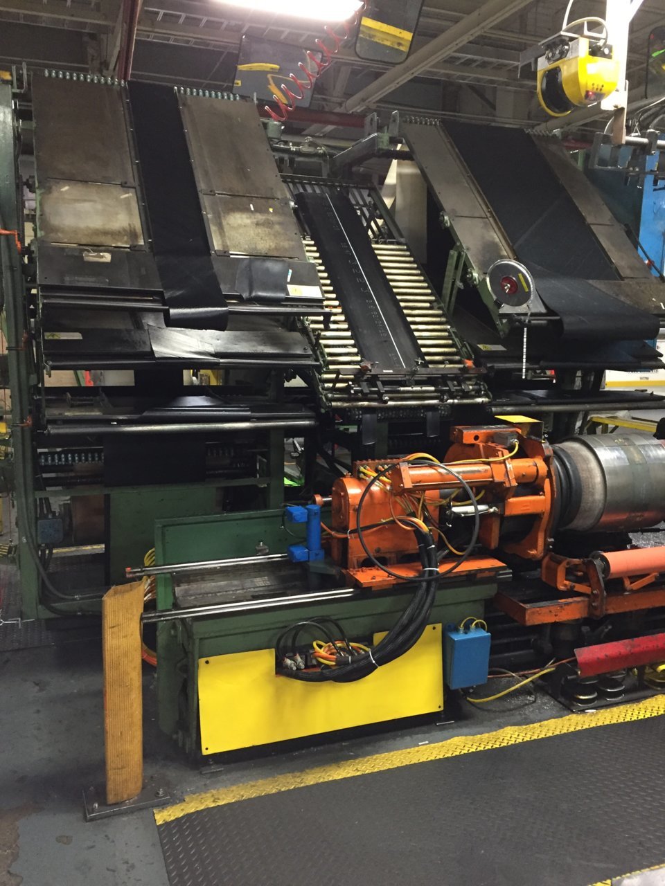

    Lawfarin
    Lawfarin Who me?
    Oct 25, 2015
    #167659
    7,936
    Beetle Juice
    NY
    2024 GMC Sierra
    You may be right. Might go off rating having the belted cord. I build Moto tires and we build what we call a 7-0 tire but consider the innerliner a “ply”. However most constructions are 3 plys and 2 breakers. It all varies. Some radial will run 2-3 plys and 2-3 breaker. Then we have jointless band race tires.
    Anyways down in our PCR and LTR dept I know most carcass are 2-3 ply. I always assumed since we have 7 ply tires in moto, they ran more plys on the carcass when they built a 10 ply. I’ll have to find out for sure. I think they may consider the sidewall as part of the ply rating since it’s folded over
