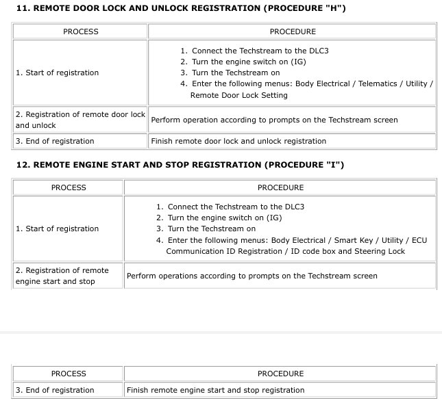

    I will dig up the material, but short version is the locksmith didn't do it right. The modules that unlock and allow starting are different and they only got one setup correctly.

    The main body ECU handles the remote lock/unlock functions, the certification ECU handles the smart key engine start. The basic registation process for each are below. From your descritpion the locksmith still needs to regiester the keys with the main body ECU.

    Thanks for all the info and advice. The dealership had a cancellation this morning and got it in. They confirmed what you said, Matt. Cost for the fix was covered by the locksmith so I came out whole on the deal.
