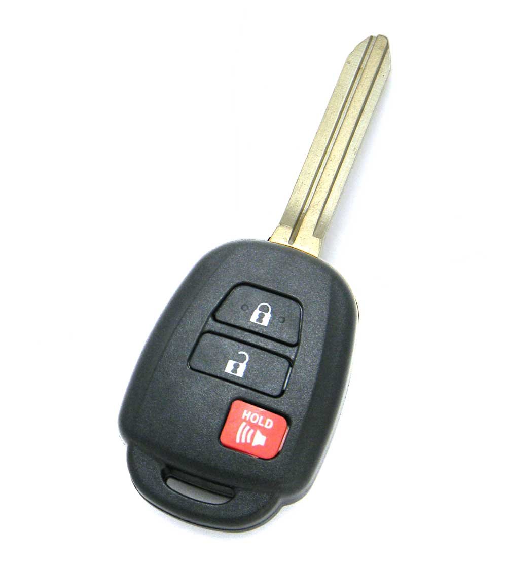

    Hello....my taco has a H key with built in fob, Question this fob doesnt transmit signal until you press the button? Or always transmitting?TOYRHK20R-MAIN2.jpg

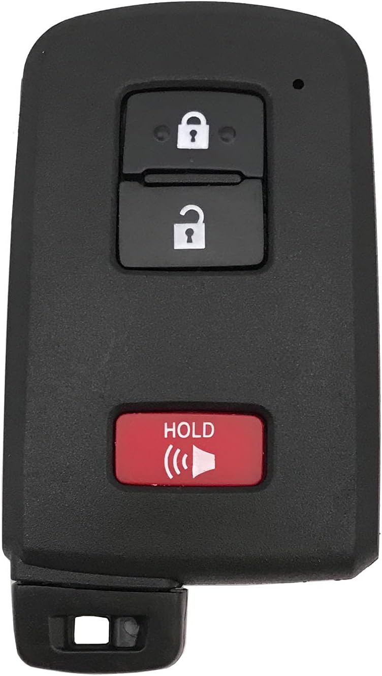

    Only the keyfobs that looks like this transmits a signal always (unless you manually disable it):

    As mentioned above, the keyless fob is always transmitting. It is advised to turn this off so the signal can't be intercepted and downloaded to a blank fob by a thief. To do this, I believe all you need to do is hold down the lock button while you press the unlock button twice. You'll see the red light blink a few times. You'll know the fob is off if your truck doesn't automatically unlock when you grab the door handle. To turn the fob back on, press any button.

    Only transmits anything when you press a button
