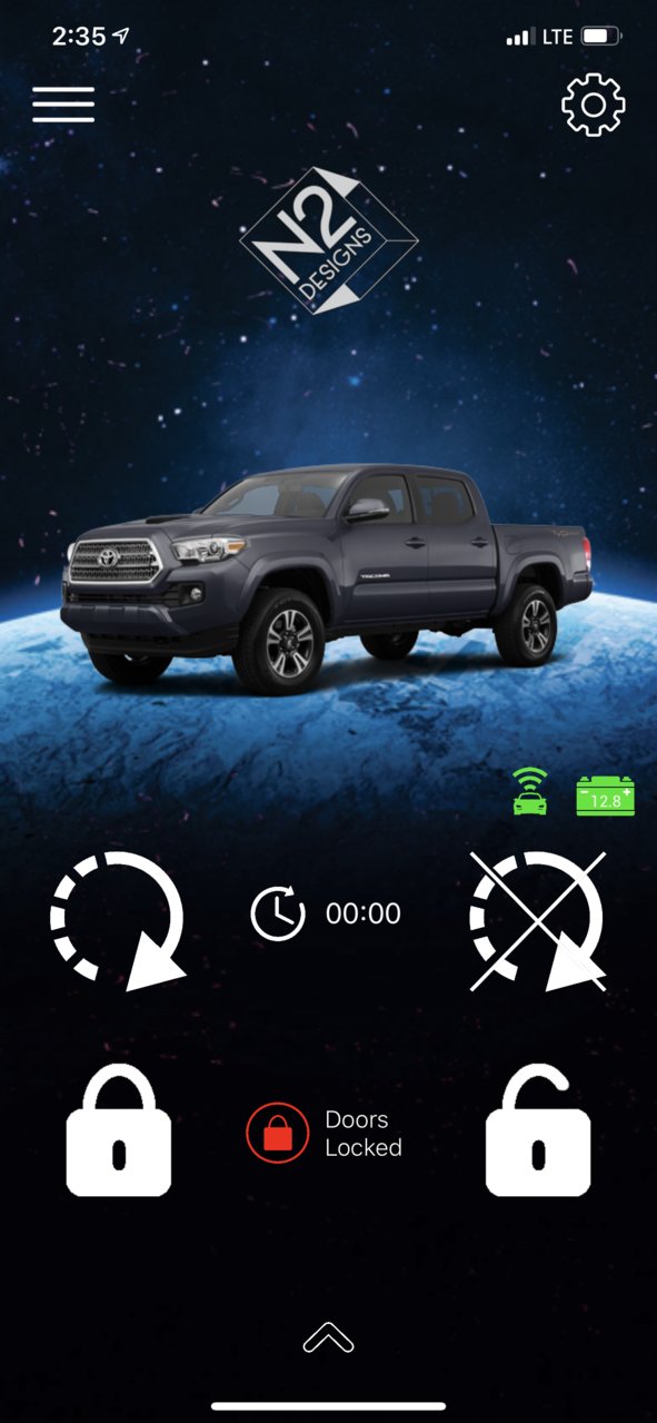

    I have a Fortin Remote start from N2 and use the cell module. It costs like $33 bucks a year if you pay for 3 years in advanced and to me totally worth it. What i use it most for is to check if i locked the doors. I tend to forget alot and this has saved me the grief of having to go back to the truck and check. I do also use the remote start occasionally.

    Thanks Tacotruck, I'm leaning towards the N2 not in a hurry so I'll keep reading for awhile. Thanks. I am planning on the cell module too.
