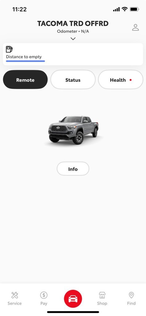

    2022 TRD OR bought in April 2024. It just stopped working for me as well. I tried over and over and every derivation (2 clicks, 3 clicks, 4 clicks, various clickclickholds, fast clicks, slow clicks, fastfastcslow, etc) that I could think of with both fobs yesterday. This morning, I tried BT connections, looked for anything in settings on the dash, tried the same derivations over and over. Then I subscribed for the trial (3 months on the app), immediately walked downstairs, grabbed a fob and it started working again. It is 100% the app.
    Now there are only 2 questions remaining for me. First, what is this 10-year trial that everyone is talking about? It's not anywhere on my app. Secondly, I think there should be an option on the app to remote as well, which there isn't. This is all that I see:
    Don't want to derail this thread, but if anyone can comment on this it would be helpful.
    Edit - nevermind, the Service Connect trial went from 3 months to "Up to 10-years" once I activated it. Weird. Dynamic Navigation trial went from 3 months to "Expires on Aug 03, 2025", which is 8 months. Also weird.
