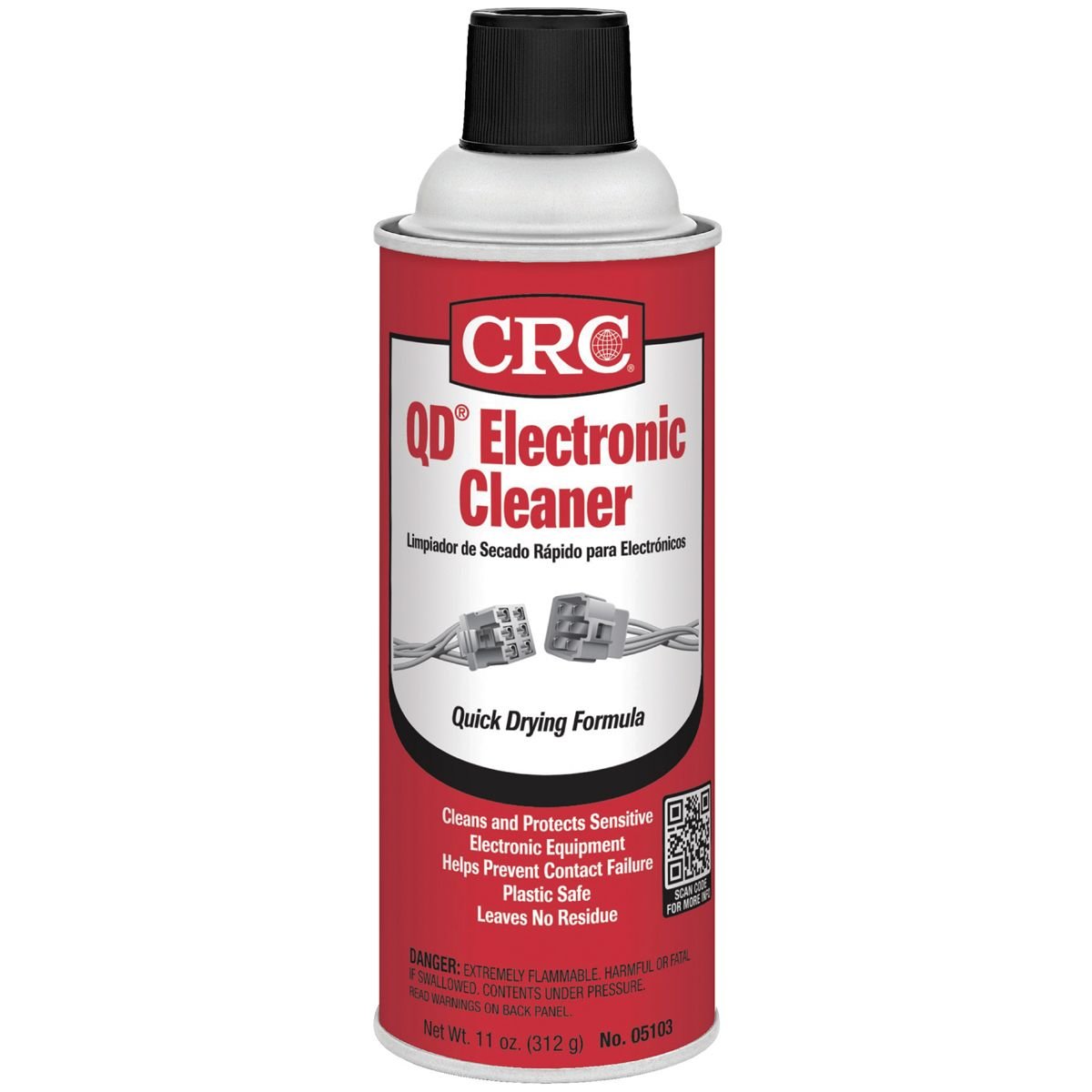

    In your cleaning of the switches try some CRC Electronics cleaner.
    Won't hurt anything, may help. Even HF has it.

    Excellent! I think I have some of this lying around somewhere. I'll give it a shot. Thanks.
