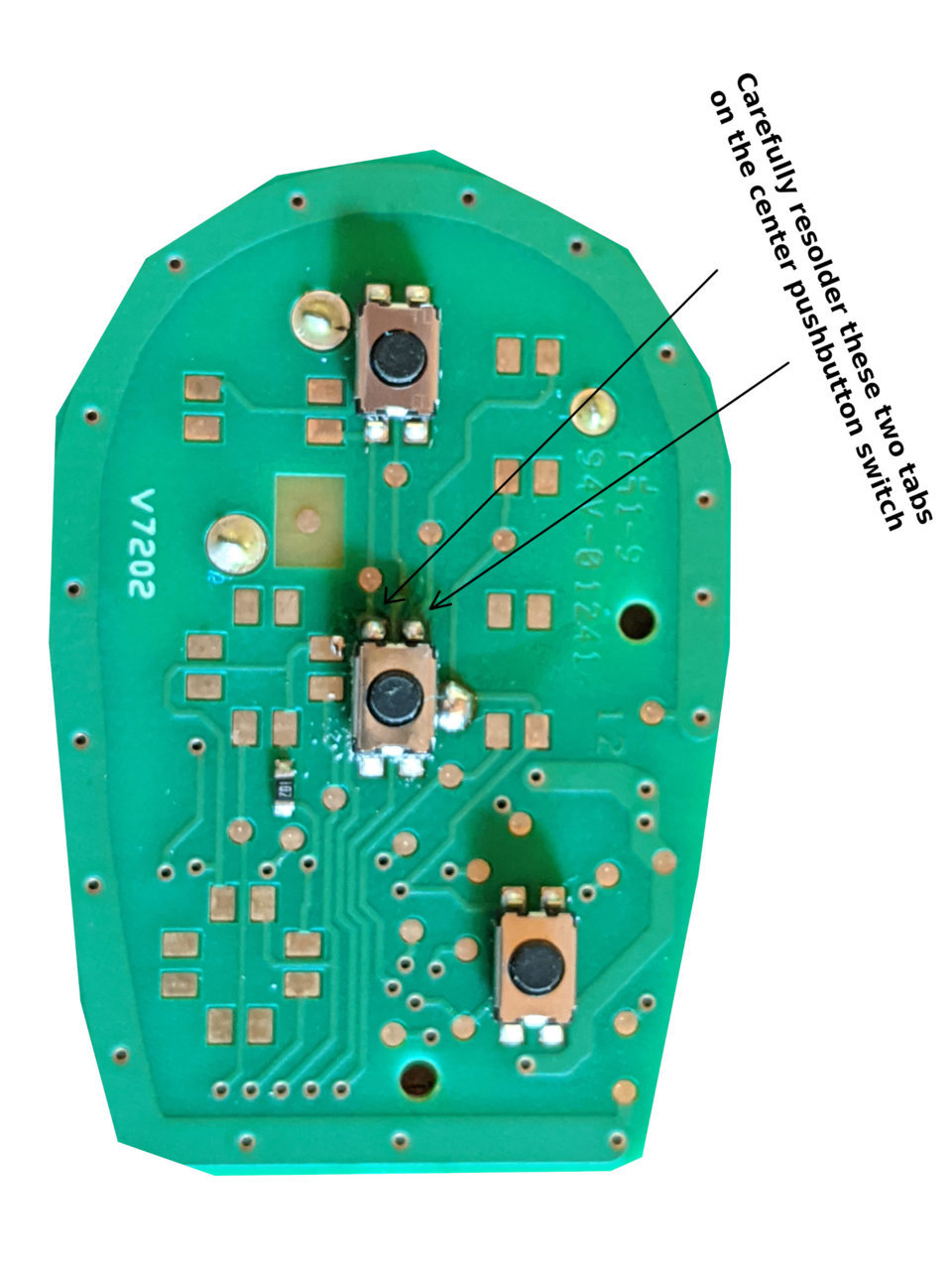

    I just bought a 2013 Tacoma from the first owner. He gave me two fobs saying "these don't work, but I cleaned them and put in new batteries and they still don't work". I determined that the batteries were good 3.08v and that the lock and panic buttons did work but the unlock button did not work --- curiously the same behavior out of both fobs. The center button (unlock) has 4 surface mount tabs. Only two of the tabs have traces. I verified that the button did work, but that it did not affect voltage on the traces. So I resoldered the two tabs on the unlock button and the fob works fine now. Same fix worked on the other fob. Thanks TigerTaco4! fob-fix.jpg
