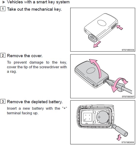

    Probably one of those tiny little 3V coin batteries.

    CR2032 according to the manual.

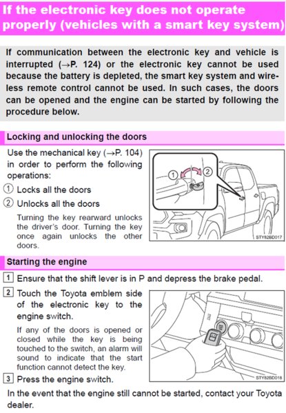

    typical coin battery. good thing is if the battery completely dies within the fob, you can still start the vehicle if you physically touch the fob to the start button unlike some PTS system that I have seen where you cant even do that.

    it will beep for 3-5 times every time a door is opened while running and the fob it not near the PTS button (meaning on a person sitting in the drivers seat).
    this happens on my 14 4Runner LE with the PTS.

    "In the event the engine still cannot be started contact your Toyota dealer"
    More of a reason to buy the M/T, cause no PTS system.
