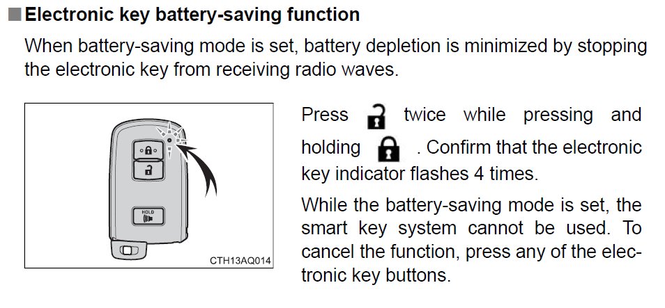

    Have a 17 of. key fob is blinking. Only about ten months old. Wouldn’t start unless I put up against the switch. Started up. It’s not blinking anymore and starts up regularly. Is there a safety switch or something I pressed?

    Nope. Just replace battery to be safe

    Maybe it was in battery saver mode?

    If battery is low on the FOB, you should get a center dash warning before it gets too low to work (I have seen it myself on the TRD trims, not sure on poverty trims).
