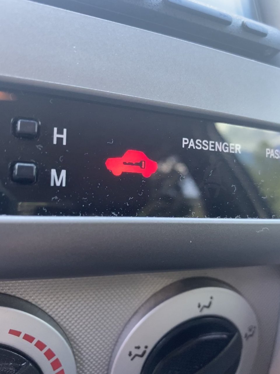

    Is the security light next to the clock flashing with the key on when it won't start?

    I didn't notice but I will check that out the next time it happens. Can the transponder in the key be replaced
