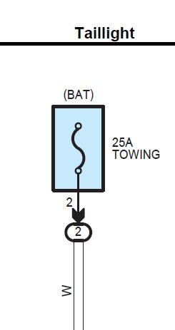

    Destin, your Taco must be special. That fuse is HOT always, it's connected to the Alternator buss bar.

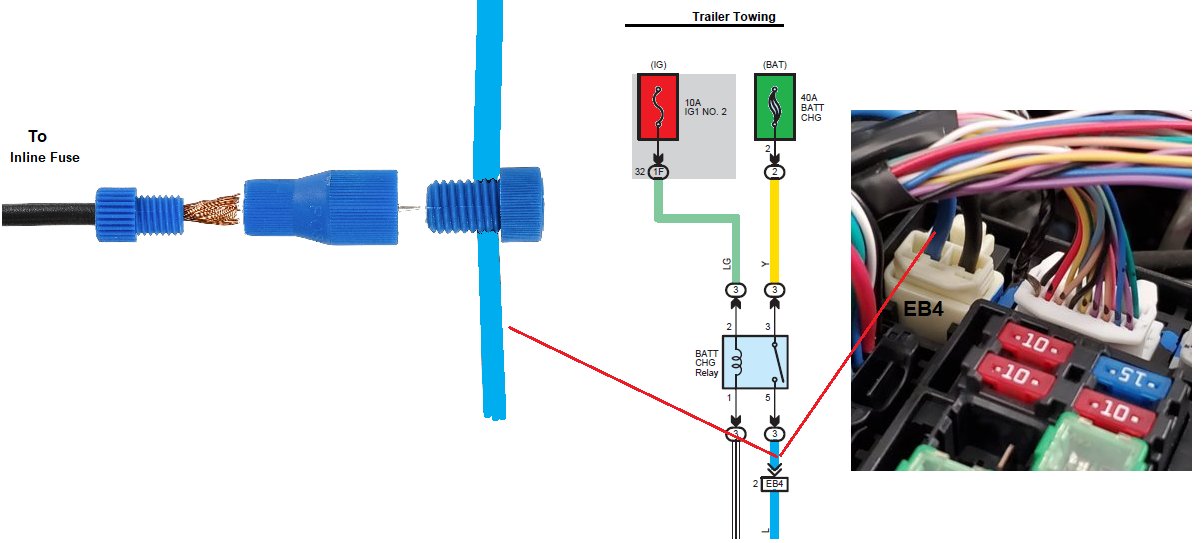

    Here's a choice at the engine bay.

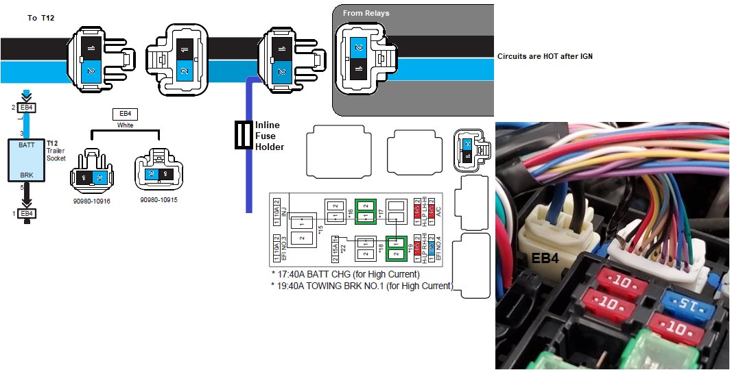

    Or this:

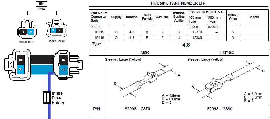

    Parts:

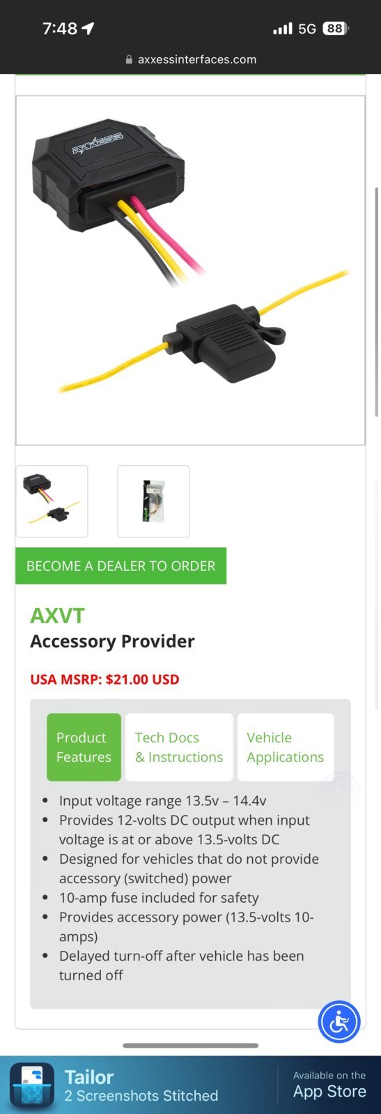

    if you don’t want to splice any factory wiring, I used this quite often back in my stereo installer days. It creates a trigger when it senses a higher voltage (which means the alternator is running)

    You don't like the jumper harness on post#10?o_O:D

    That depends.
    Can I buy one of each connector and one of each pin and a crimping tool and 2 short lengths of 10? 8? gauge wire
    all for under $25 :D

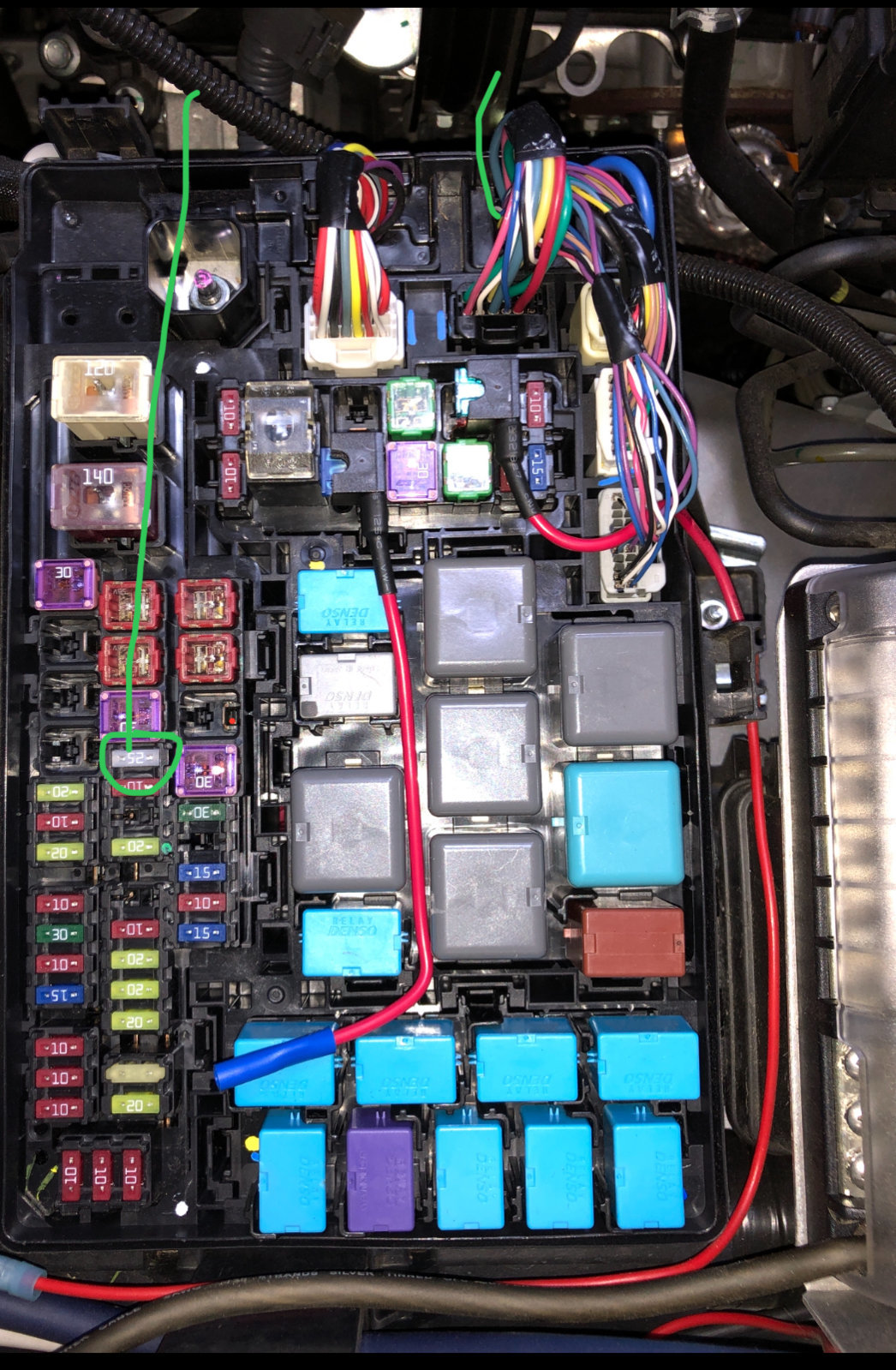

  14. Feb 16, 2024 at 1:29 PM
    apolsinelli02
    apolsinelli02 [OP] Member
    Nov 20, 2023
    #437839
    19
    2020 TRD Sport
    2in camburg Lift, Method 305 Rims, BFG KO2 33", LilB Fabs Hybrid Bumper, BA4x4 Rear bumper, Tune, various other odds and ends

    Yes
    Yes
    Look closer at the info...
