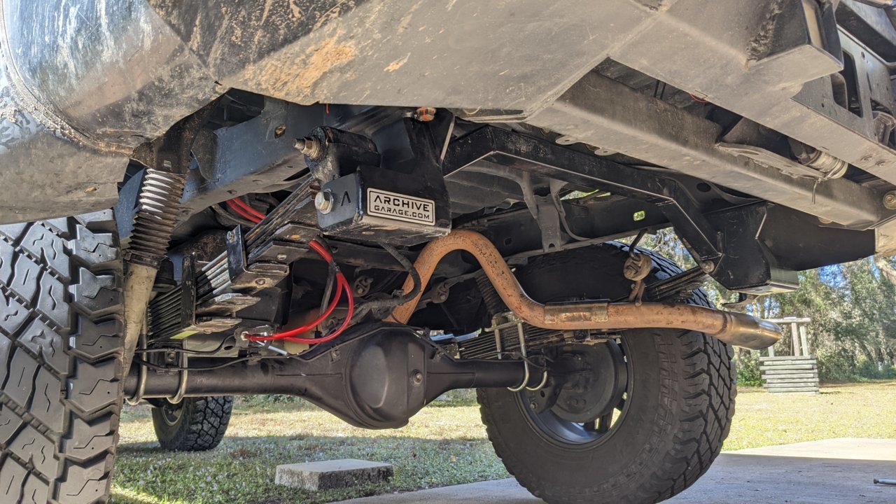

    Love them, I know I don't get the most out of them as I don't play with the adjusters much, typically have them firmed up for the street then ake them soft for the trail. As much as I hate to admit it my truck spends more time on the street than the dirt but I absolutely love them night and day difference over the 5100's and 887 coils I had.
    They came with 11" (IRC?) 600lb fox springs I switched over to 700lb 14" King springs and it rides fantastic with all the weight on the truck.
    I think the Fox DSC's especially if you get them custom valved through Accutune (I did not) are about the best mid travel system you can buy.
    The lift is indeed determined by how far you crank down the adjustment collars though you can run into coil bind if you go too far, that's when you need longer and or firmer springs like I put in so yes you absolutely can.
    Accutune recommends not exceeding 21" from center of lower eye to top of the coil bucket with weight on and as I am set up that's exactly where it was when everything was fresh, I may have settled 1/4 now but that's probably for the best to not be at theoretical max, anything more than 21" really accelerates wear on the CV's.
    The biggest suspension upgrade I have done so far though was on the rear with Archive Garage Hammer Hangers and cross brace, I regret not getting those sooner.

    Haven't done any welding yet, just cut off the old chincy bits and bolted in the hammer hangers installed the leaves and the other U bolt flip, did that the day I got back.
    Won't be welding on the new shock relocation stuff until I finish closing on this house but the good news there is it has a nice workshop with a lift in it to make things easier.
