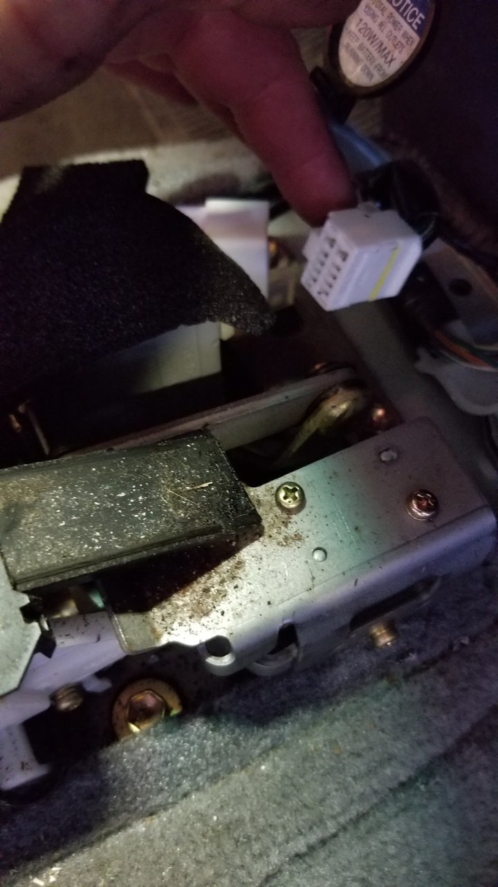

    Key started getting stuck in ACC and not turning truck off. Had to disconnect battery. This worked, but a pain to do every time.
    Removed center shift consul and unplugged the forward plug. Key operates smooth now.
    Question is, what is this to?
    Drive and shift are not effected. No other issues present with it disconnected.20180722_154329.jpg 20180722_154338.jpg

    I appreciate everyone's take; however, I can't help but feel like some of you are not actually reading the issue.
    This is not a steering wheel lock problem. I know full well that it is a relay issue.
    My original question is if anyone can help identify what relay is pictured?
    Again, the truck does not turn off unless 1) battery disconnected, or 2) relay unplugged.

    Is it the shift solenoid? I’d just replace the entire shifter console. The relay and solenoid can only be removed by de-pinning.
