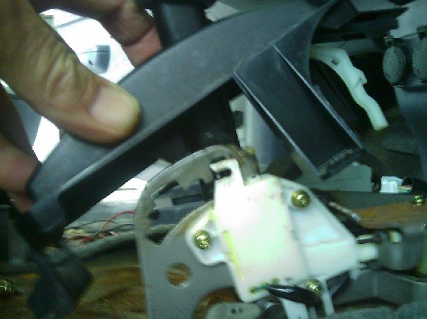

    I have a 99 Prerunner 2.7L with automatic trans. Recently, I have been unable to turn the key off after placing it in park. I know there must be a switch on the trans or somewhere, just wanted to know if anyone has had this problem. After putting it in gear and back to park several times, I am finally able to get it to work. May be running out of time.
    7/15/09- Specifically, when turning engine off the key will not turn to LOCK position and remain on ACC. I noticed that when I press on the brake when its working I hear a clicking noise from the shift console area - no click= no lock. Sounds like a switch intermittently failing. Any ideas?

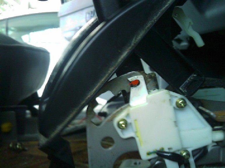

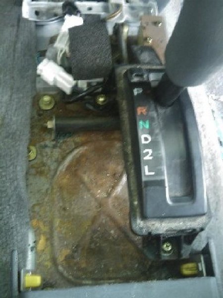

    Over time the pivot tube at the base of the shifter becomes loose. This causes a pin mounted on the locking button on the shifter to disengage from a switch at the base of the shifter.
    When the switch is activated it allows the ignition to lock only when the shifter is in the park position. The play in the shifter causes the pin to slide behind the switch which in turn no longer activates the switch.
    I used the plastic you find on those packages you can never open to create a shim between the pivot bolt and tube (Sunday no parts). Then I carefully bent the switch mounting bracket to take up any slack that may have been cause by the wobble. Orange dot shows the pin now engaged with the switch.
    Hope this helps someone like me at the gas station with the key stuck in the ignition and no spare to open the gas tank door. Sorry first attempt at posting. Here goes nothing....
