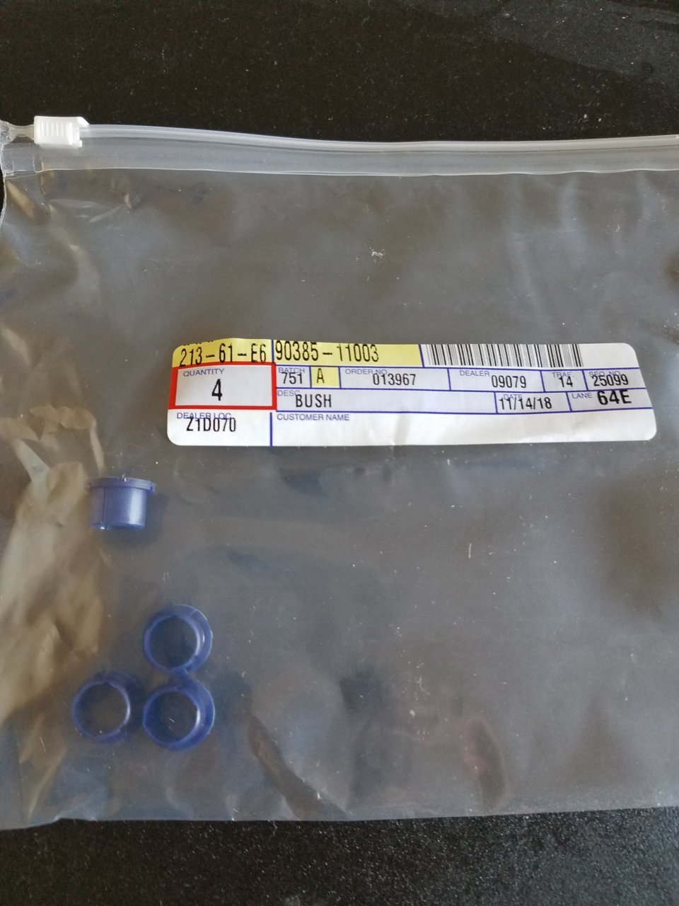

    If you go to replace the bushings, I just purchased 4 from the dealership. They're like $3 each. Here is what they look like, and part number is 9038511003. There is a YouTube video posted in a similar thread about replacing bushings due to loose auto shifter (common problem for 1st gen after a while).

    You stud. Thanks for doing the hard work and sharing :thumbsup:
