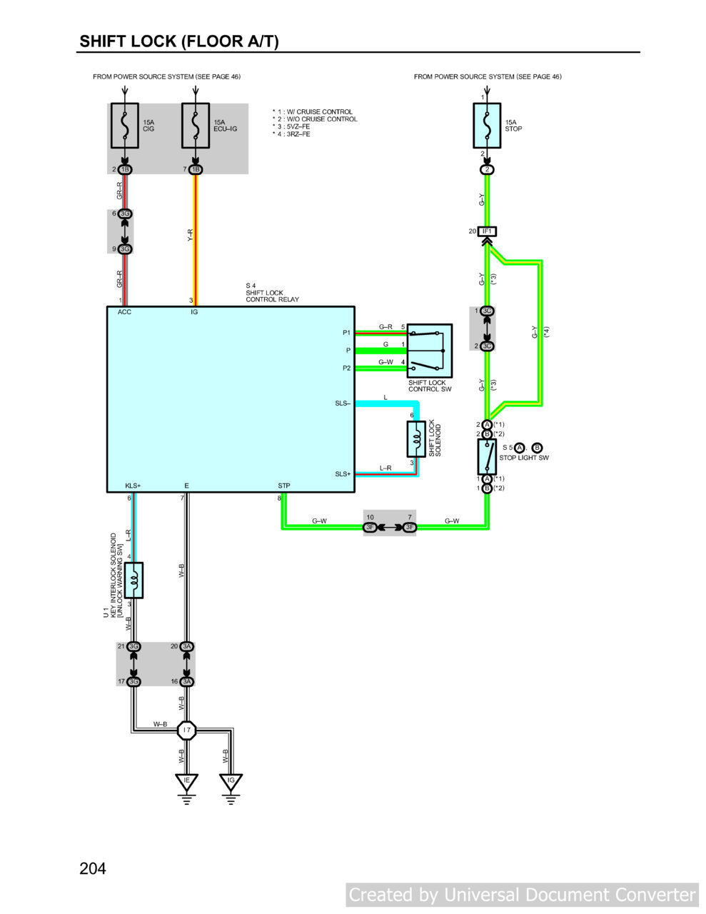

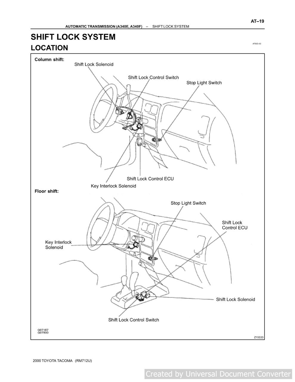

    If it comes out with the battery unhooked you most likely have a problem with the switch on the shifter that tells the Shift Lock Control ECU it's in park so it releases the Key Interlock Solenoid or the bushings in the shifter are worn out and it's not depressing the switch.

    I was having the same problem last year. After putting my truck into Park my key would not move past ACC and would not release from ignition cylinder.... I had to disconnected the battery in order to pull my key out. Frustrating!!! So, I pulled my entire gear lever assembly out and replaced all four bushings.... works perfectly now.
