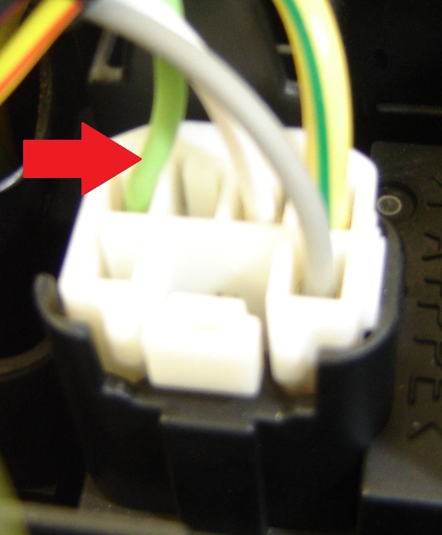

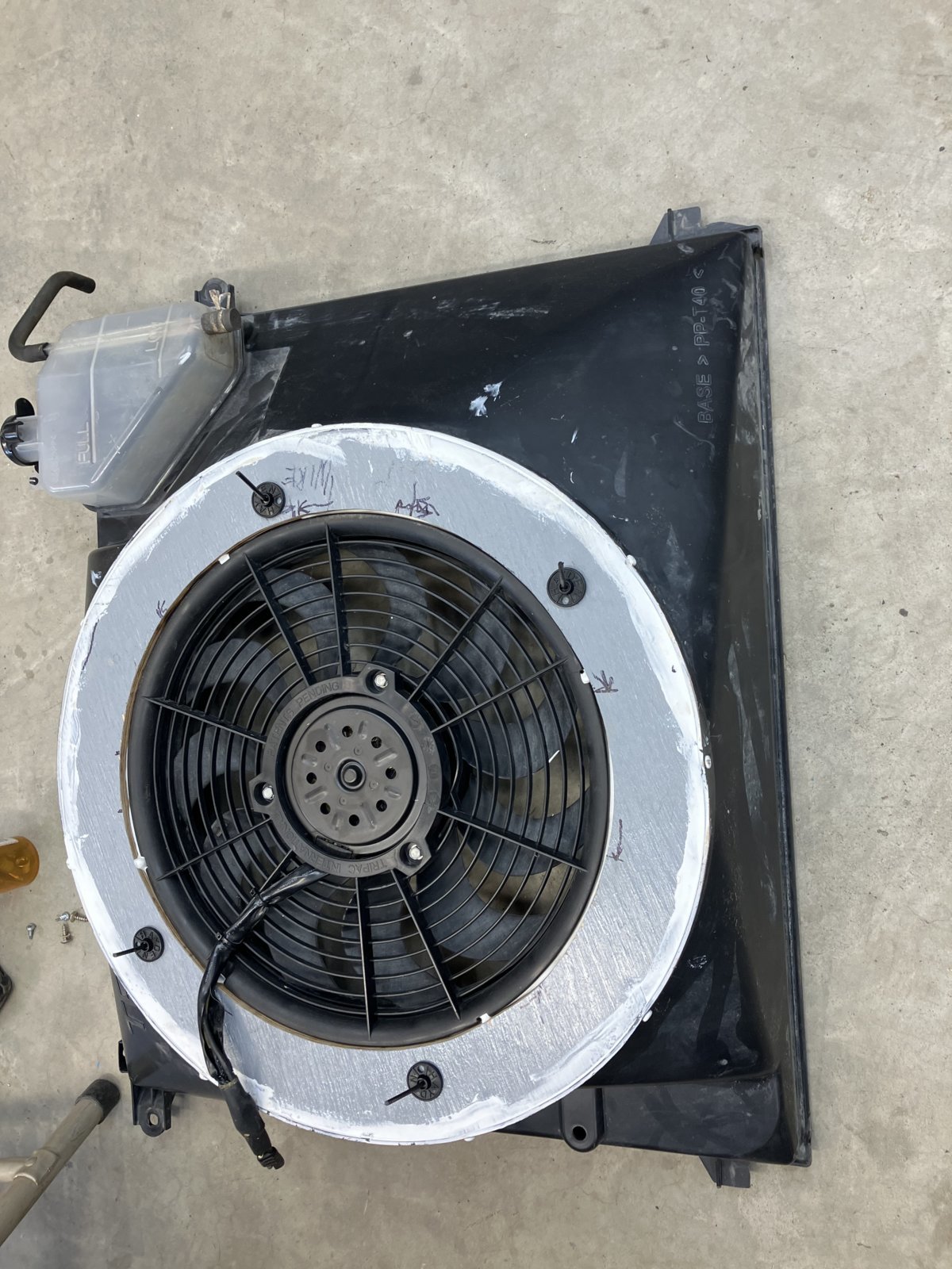

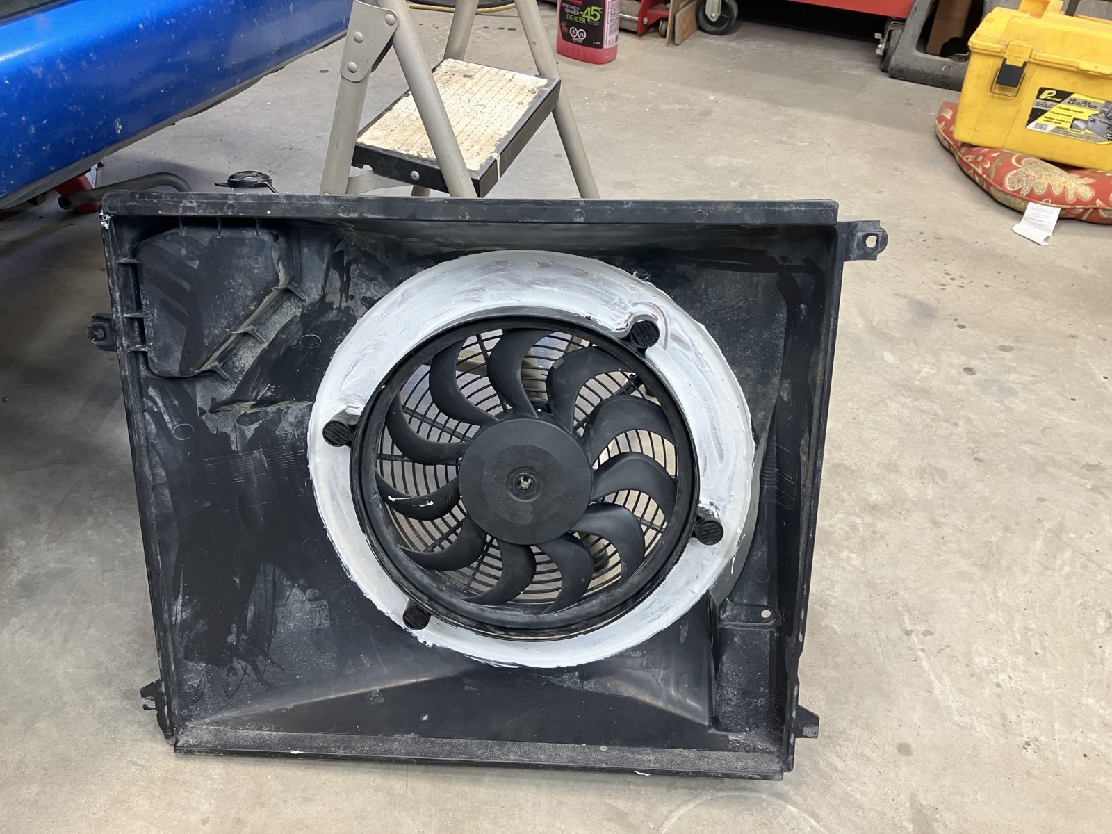

    Should be able to easily find one at the under hood fuse box, just make sure to use a relay since the fans will draw a lot of power. Generally the IGN2 wires are brown w/red stripe but always use a multimeter to test.
