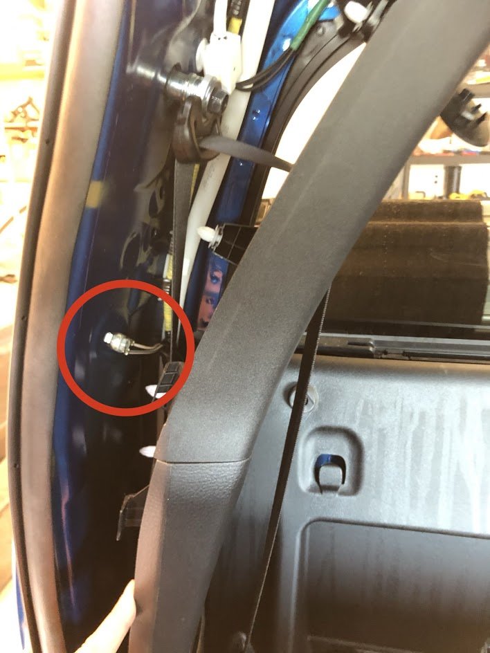

    Heads up, guys. I took Caboose117's advice and added an additional ground to my BD4-NMO harness. I ran it with 10AWG primary wire to a ground on the passenger C-pillar. That 18AWG coming from the original harness wasn't cutting it for all these lights I think.
    My fob is working as intended so far. Before this I would have to wait for the cargo lights to time out before I could use the fob to lock the truck.
    buntcake, Meeks13, Caboose117 and 2 others like this.

    so I installed from the outside. To get to that wire, you either need to come in from the outside, or via the headliner (as far as I know). Help me understand how you did this?

    I just pushed the wire in from the outside and it popped out from my headliner just above the rear window.

    You have to first at least partially peel back the panel behind the rear seat. Then if you start at the top of the pillar and work your way down you can pull it back just enough to reach the ground.
