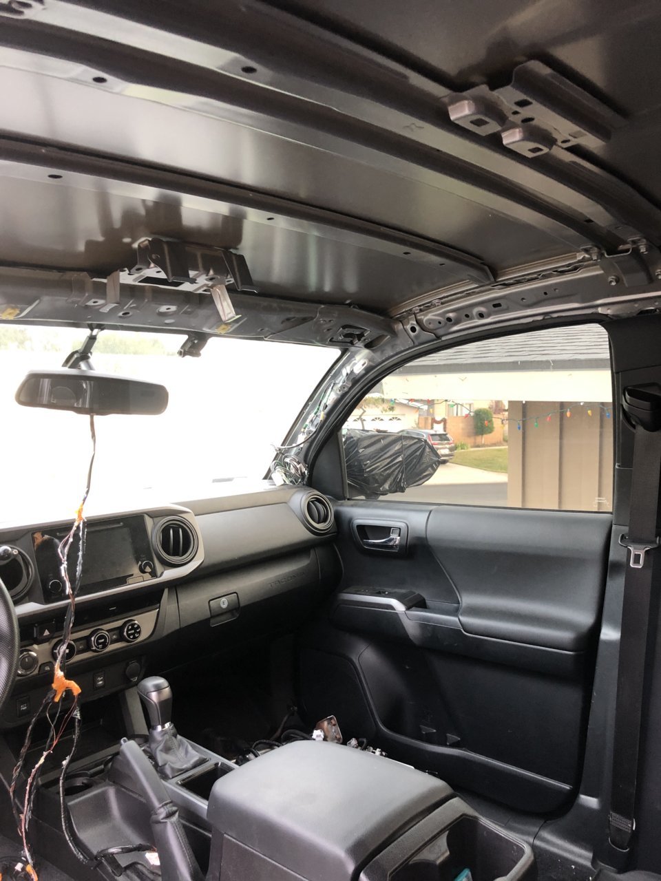

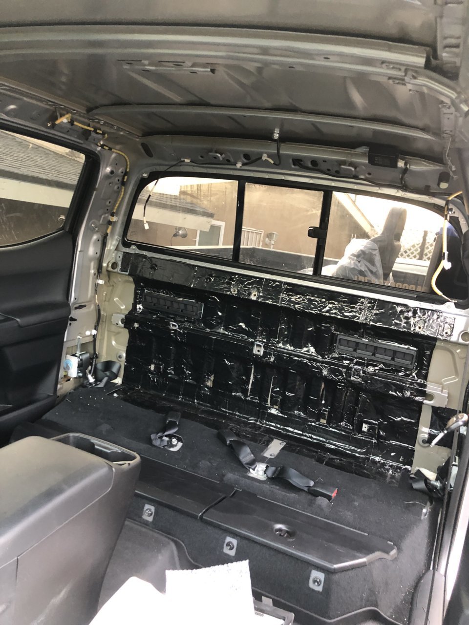

    Caboose117 foul mouthed Marine
    Aug 3, 2014
    #135375
    4,628
    Chad
    Kentucky
    ;IGY6 Rescue Truck
    smashed this, broke that, covered it up with tape and paint
    Just in case you wanted to know what’s behind all your interior
    btw
    The key fob receiver is in the back of the cab on the right side of the picture in the top corner area
