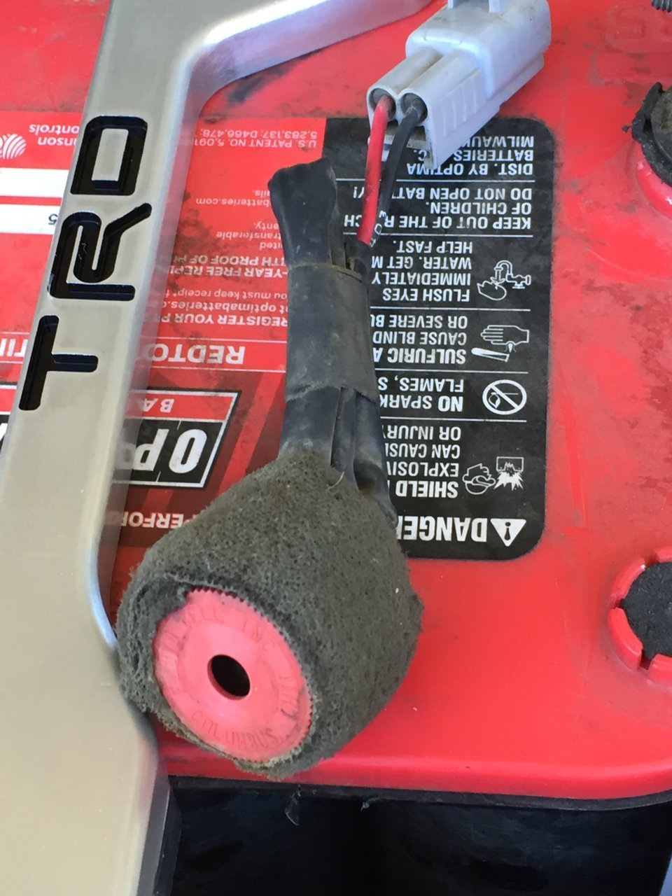

    My 04 just blinks the lights when I use the keyless entry remote to unlock and lock. Is it supposed to chime? I know my buddy's 03 Tundra did. Any advice or knowledge on this would be greatly appreciated.

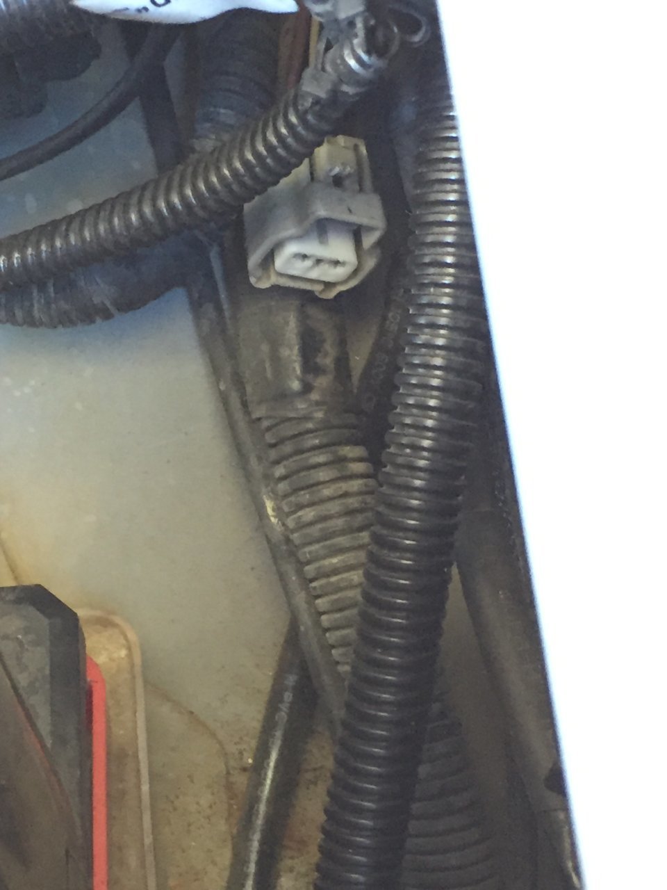

    Some tacomas came with a alarm others didn’t, my truck use to do the same thing. If you open your hood between the battery and fender there will be a empty plug if you dont have it, if there is a small cylinder shaped thing then you truck came with one.

    Thanks for the know about. I didn't know if mine was broke or what but I'll check it out now.

    On my 04 DC. I got so tired of not the horn honking, but the beeping of the piezo. I unplugged mine and took it out. Taped the plug up and forgot about it. No more annoying beep beep, beep beep!
