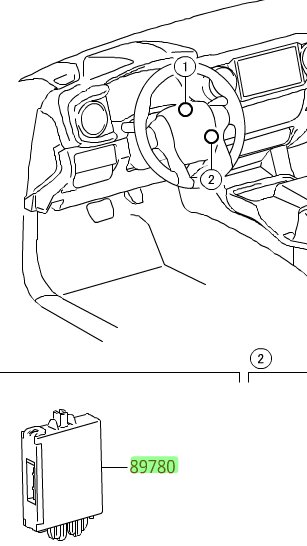

    Hi all,
    My 2017 ordered SR with the utility package will be coming in in about a week. I'm going to add the keyless entry I was wondering if I can do it myself or if I should have the dealer install it. I looked up the Toyota part but I don't know where it's located in the truck. Does anybody have any idea or a diagram of where the ECU is located, I would rather do it myself then have the dealer do it if possible. Thank you

    Located in the steering column.

    That is encouraging.
    Makes me wonder if the wiring is in there considering the wiring is in the column for cruise control and intermittent wipers.

    Thank you very much , This is very encouraging when I do my cruise control and intermittent wiper mod maybe I can do everything at the same time possibly.

    I just called the Toyota dealer and they told me it won't work. Of course I'm not 100% sure they know what they're talking about but he said that they tried it in on the SR he said the wiring is not there.

    I was also told it won't work because part of it involves a different TPMS unit (has combined TPMS / Fob sensor apparently?) that costs like $1,300 from the factory. So, not at any reasonable price point at the very least.

    This is interesting because all SR models have the same simple TPMS without the display and just reads on or off , on the SR5 and up trim levels with the larger display it reads individual tires and has a different TPMS system. When you order a SR with option code (LL) The convenience package , it comes with the same simple TPMS system as the utility package but adds keyless entry and cruise control. So I assumed that the wiring would be there also , but was told not by a dealer. I tried to order the utility package and the convenience package together and was told by Toyota that was a conflict and not available that way. So it's looking more like an aftermarket systems will be the only way.
