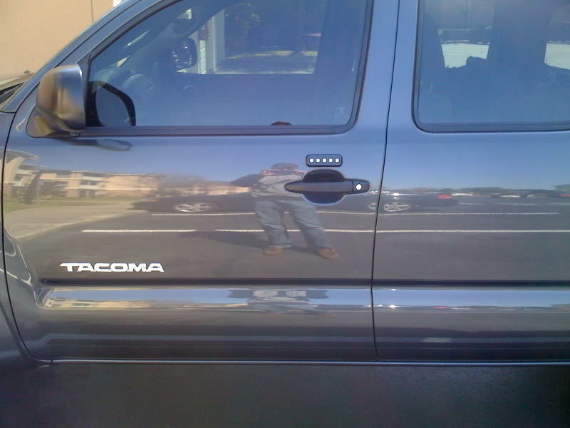

    Well, I figured I'd give an update. It took me about 2 hours to install the JBS Keypad. The only thing that was a little confusing was the programing instructions to change the security code. I was able to figure it out about the 3rd time I tried without having to call tech support. I recomend this product. I've been using it the past couple of weeks with no problem. It's helpful when I go to the beach. I don't have to keep up with my keys. I chose to mount the keypad in the bed of my truck.

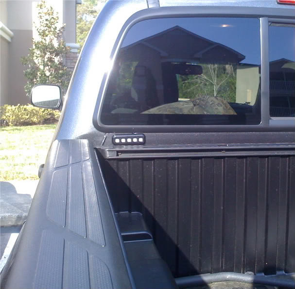

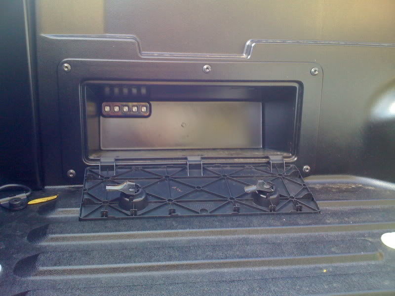

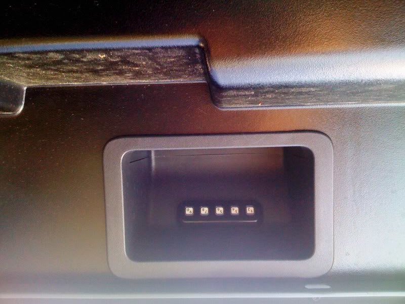

    I think under the bed rail or the bed compartment above the wheel well would be a good mounting spot for the keypad.
  13. Dec 22, 2010 at 4:34 AM
    #33
    DBZ
    DBZ Hunter-Gatherer
    May 24, 2010
    #37720
    67
    South Georgia
    2010 DC PreRunner TRD Off Road
    Fog lights anytime, DIY shorty antenna, carpet lined storage bins, debadged, tailgate hoseclamp, DIY washable cabin filter, AFe Pro-Dry air filter, Protecta bed mat

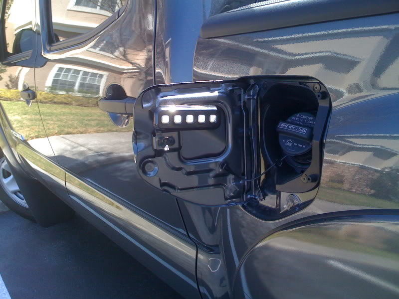

    I have always thought the OP's idea of putting it on the inside of the gas door was a good idea. That keeps it hidden, but accessible and you can see the keys as you enter the code. Although it looks like it could be crowded with the keypad, gas cap, and the gas cap lanyard.

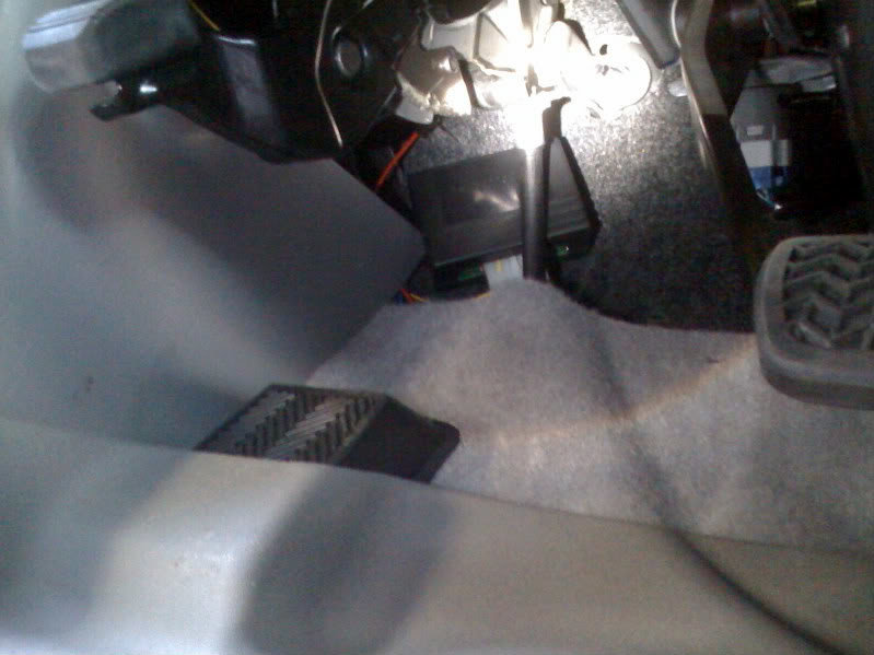

    Just order mine I have seen 2 type on ebay ... They other one as option like to open a trunk or an other auxilary ... but look also easier to program(got a switch on the box) but it's not like you change that code every 2 houre ;)
    wondering where you plug it ... is it possible to plug it at the same place as the factory keyless entry send the signal ... so make the parking light flash with that bip sound too ...
    Because I remember when I was looking my self inside the truck the switch didn't work to unlock the door I had to move the button manually or have to use the keyless entry again ... so if i plug my controle box of my key pad on my switch like some of you seen to have done ... I'm wondering if it'S going to work ...
    Thanks for your answer ...

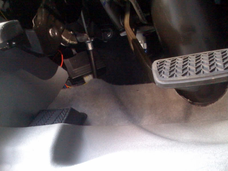

    I install it on my 2011 last year and it'S awsome for the wiring diagrame since a couple color of wires seem to change every year I recommand to do like me and pay 15 $ I think for 3 day and Guet access to everything you want on your tacoma ...
    https://techinfo.toyota.com
    That thing is aswome it's probably what they use in Toyota garage ...
