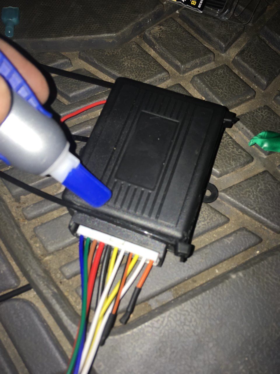

    this pic shows how i glued some zip ties to the receiver/ brain to mount it. also shows all the wires so i can give a breakdown.

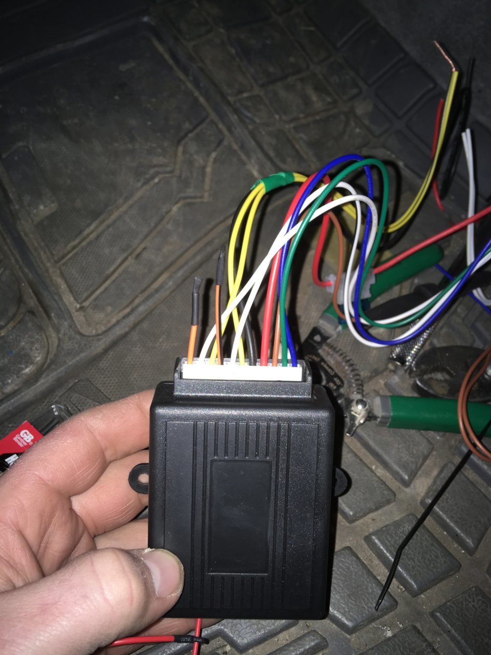

    WIRING
    The oranges-
    are for cars that need a pneumatic motor installed to operate old school locks with no existing power. My truck had power locks just no keyless entry so I didn't have to do shit with these. Just cut 'em and shrink wrap 'em
    White= Lock/ "closing signal/arm" hook it up to your purple wire in the kick panel that comes from your driver door.
    White/Black stripe= unlock "opening signal/disarm" hook it up to the green/black stripe wire in the kick panel that comes from your driver door.
    Both Yellows and the Black= these need to be grounded. easiest solution is in the video. crimp them together in a screw loop and ground them inside the kick panel.
    Red= Your power source. Hook it up to the constant 12V White/Blue stripe going to your ignition. shown clearly in video
    Brown= Positive signal to your Parking lights. Hook both of these up to the DARK green wire in the White terminal on the upper left side of your driver fuse panel. see video.
    Green= supposedly sends a signal to roll up your windows. I didn't really car about this since I live in Colorado where it seldom rains and I tend to leave them cracked so it's not a complete oven when I get back. But I also couldn't seem to make this wire do anything. Maybe you need to hold Lock down on the clickah or something. just cut it and shrink wrap it.
    Blue= Third button on your remote. Hold it down and this will provide a ground. I hooked it up to my horn so I can find the truck in big parking lots. Green/ Red stripe in the white terminal upper right side of your driver fuse panel. see video.

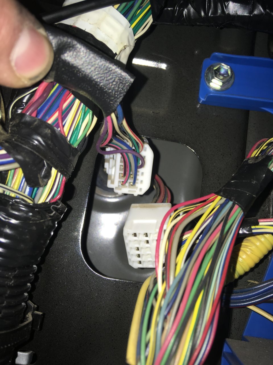

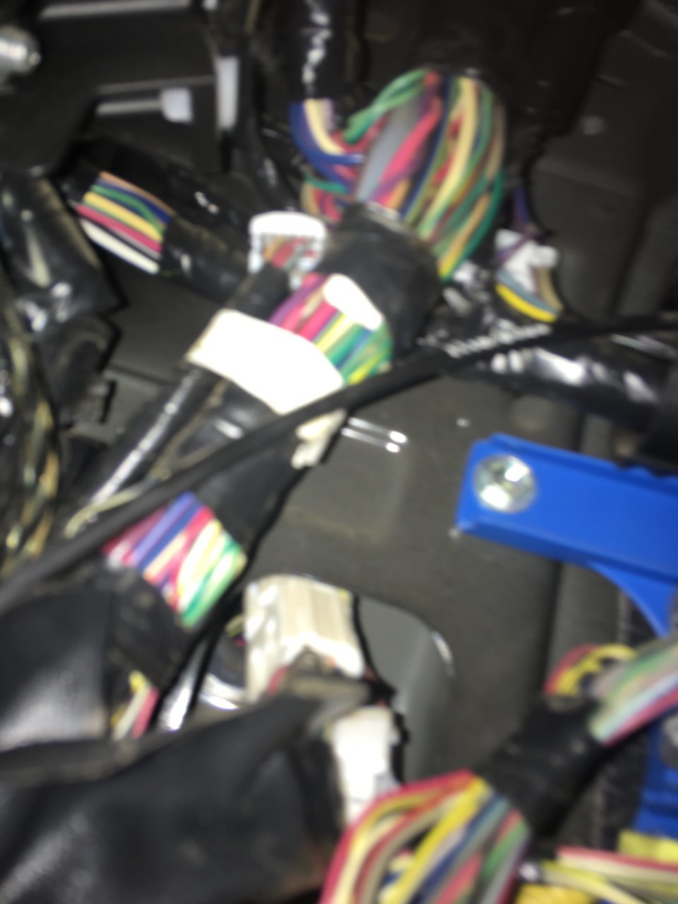

    **Finding the Violet(purple) and Green/black stripe wires:
    Fuzzy pic of the taped up terminals coming through from your driver door to your Kick panel.
    Clearer pic after I removed some electrical tape... the violet(purple) wire and the green/black stripe wire can be seen in that white terminal on the left coming through from the driver door.
    If you watch the video you can see I just traced them from there to a more accessible spot just by my left ankle in the kick panel.. I made my connections here so i could check them in the future if the keyless entry acts wonky at all.
