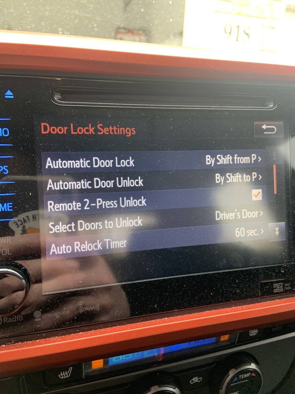

    Hello!
    Recently bought a 2017 trd offroad and i realized that i have keyless entry on it but it doesn’t work right now! Key buttons work from a distance still and my push to start works fine. Does anyone know what the problem would be? thanks!

    Have you checked your settings? It is a programmable feature.

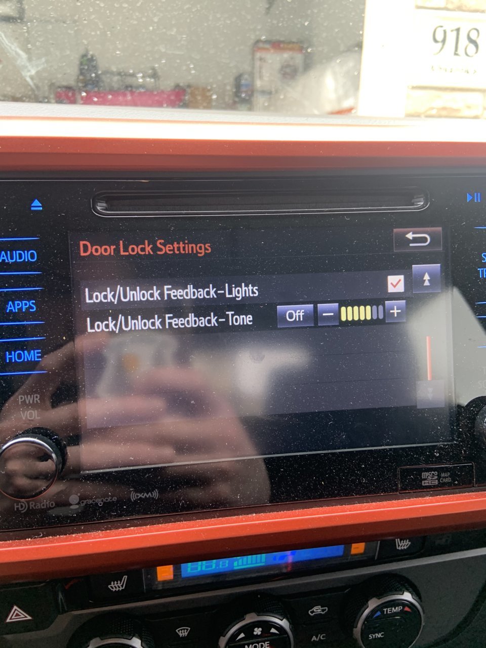

    CDCAE371-9B37-4C59-A0B6-E54720DA4511.jpg C0F27BA1-7411-40BB-AD51-B5E65481CB09.jpg I looked through the vehicle door lock setting and i’m not seeing anything on the keyless entry on here. I also swapped the batteries in my keys and it didn’t do anything either, it is possible that both batteries could be low but I figured since the push to start works I would think the keyless entry should be working too

    ??? thought I read somewhere that there is a way to disable/enable with the button(s) on the FOB. :help:

    Holding Lock while Pressing Unlock Twice will disable keyless entry. Pressing any key with cancel that
