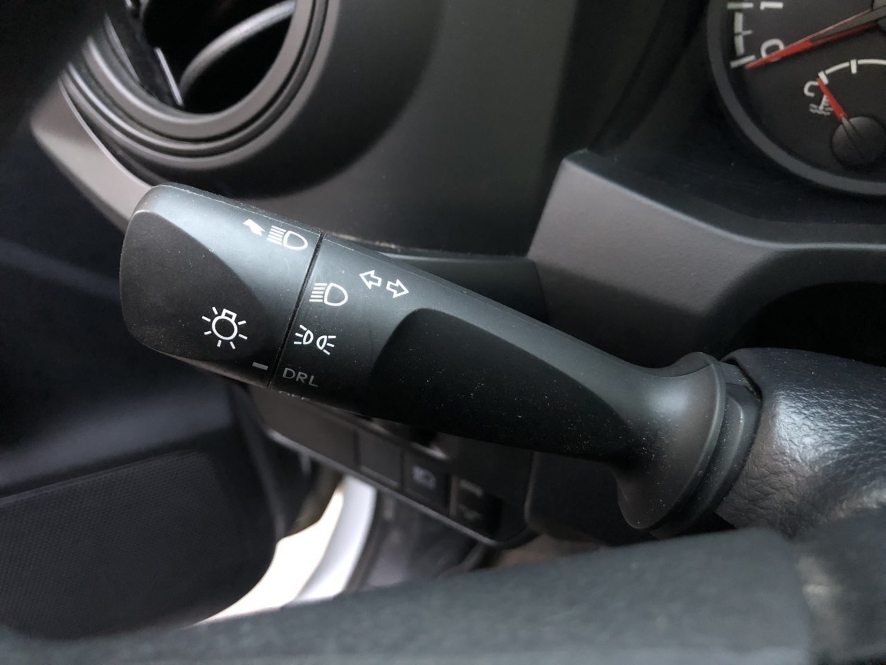

    Thanks - I’ve been using the keyless linked in this thread for about a year. It works great, but the lighting features have never worked. Until now I just let it go and disconnected the taps going into connector C11.
    After reading how the controller is programmed — it kind of sounds like it’s designed for the higher-trim light stalks... which defeats the purpose of designing a keyless system for the base models!
    Here’s the stalk on my truck that doesn’t have the headlight control features the instructions seems to rely on:
    I hope I’m wrong, but it really does sound like connector C11 interacts differently with certain lighting stalks.

    Did you test this? the #17 is the Flash select on the stalk.

    Thanks! I’m not sure what you mean by flash select. There doesn’t seem to be many options on my light stalk.

    When you pull the stalk back, you FLASH the high beams...when you push forward, it locks into high beams...
    the missing "feature" is the auto light control #20 (white), wire is there but no connection on the stalk. And no, changing the stalk does not activate the auto light feature.

    Yes that works just fine. So if #17 controls flash, are you saying the kit is designed to turn on my high beams when I unlock and lock the truck? That’s horrible!! It’s like walking into the sun when I unlock my truck with that wire tap connected. Is there a wire that just controls low beam on that connector?

    #19 - yellow
