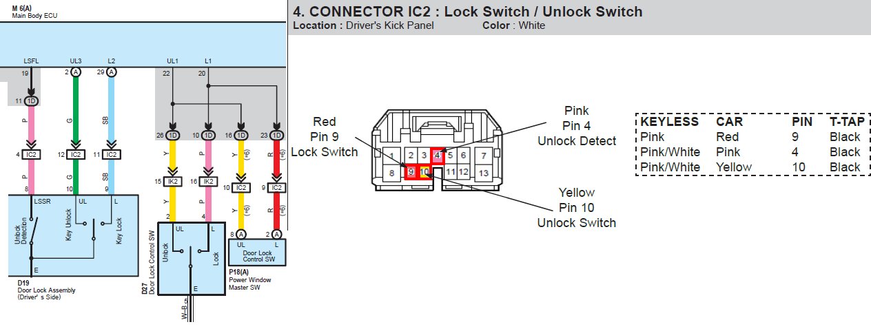

    I am pretty sure the problem lies with connector IC2, as this is the only connector that deals with this. Also at one point in my struggle, I forgot to plug IC2 back into my truck and it behaved the same way (ie only unlocking the drivers door)

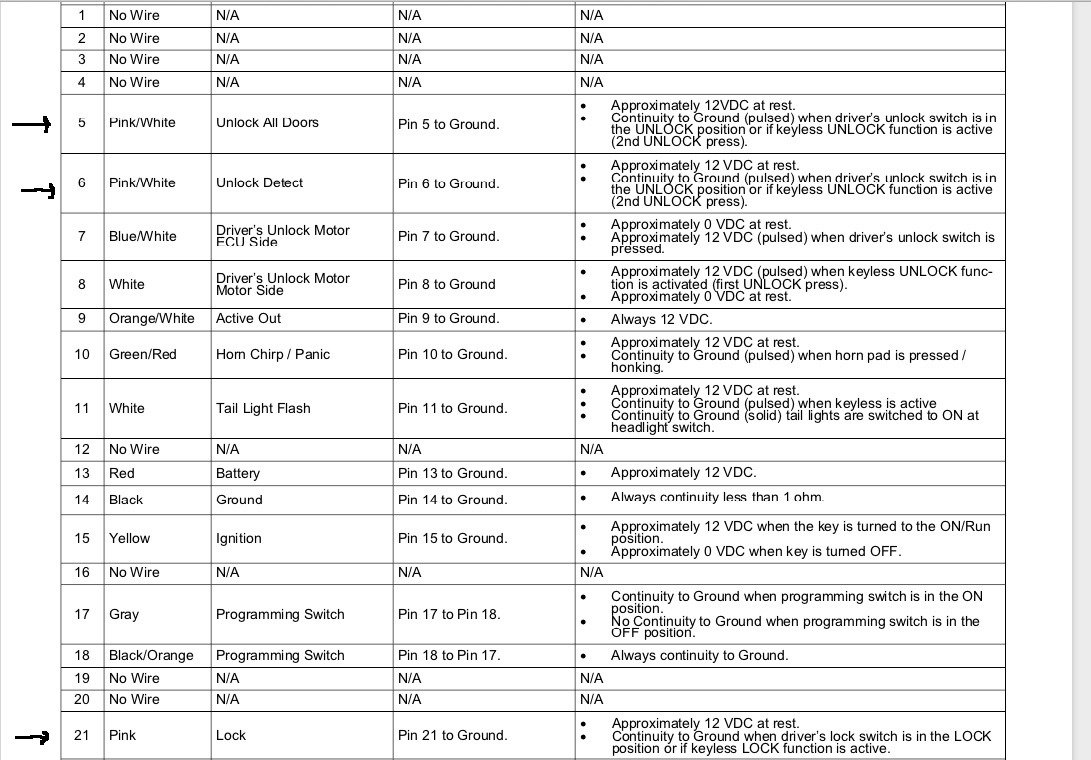

    There are 3 wires tapped into by this connector (pin 21 Lock switch, pin 6 unlock detect, and pin 5 unlock switch) I have checked and rechecked the connection points but do not see any bad connections. I thought about cutting the wires and crimping them directly but would rather not alter the truck side if possible.
    Anyone know how I could troubleshoot this? I am not even sure I don't have a bad device.
    Thanks. I know this is quite technical and I can follow directions to a tee but when it comes to troubleshooting I am lost. There is a sheet that outlines the pin connections, which doesn't mean much to me.

    Check that the T-taps are on firm...

    Thanks - I did check, the one I even redid. I may end up hard splicing them (ie not using the taps). Really hate doing that. If I knew for sure it would work, I'd not be so against it. What I was hoping for was a way to check it with a meter or such. Could even be a defective unit. That would be my luck.

    The unit provides a ground to unlock n lock just as the door switch and key switch do. You could test these wires removed from the connector/T splice by placing a fused LED and placing the ground sude of the LED to the units wired thus verifying it lights up on unlock n lock. 2 LED or one switching the ground to the units wires.

    Update, using your suggestions I figured out what is supposed to happen for this to work. The two wires in question on the truck, when you ground them, it locks or unlocks accordingly. So the pink/white wires from the keyless module are supposed to provide a ground when you press the lock/unlock buttons. Well they don't. I double checked my main ground (which I had little hope of since I don't think any of it would work if it were not grounded, anyway), my ground was good. I have a feeling the relay inside the module doesn't have a ground to provide to the pink/white wires when you press the buttons. I can hear them click so they are getting the signal, but they obviously aren't doing their job. Anyway I've written to the company to exchange the module. I hope they don't want the whole harness back (I checked continuity of the harness wiring and it is good)
