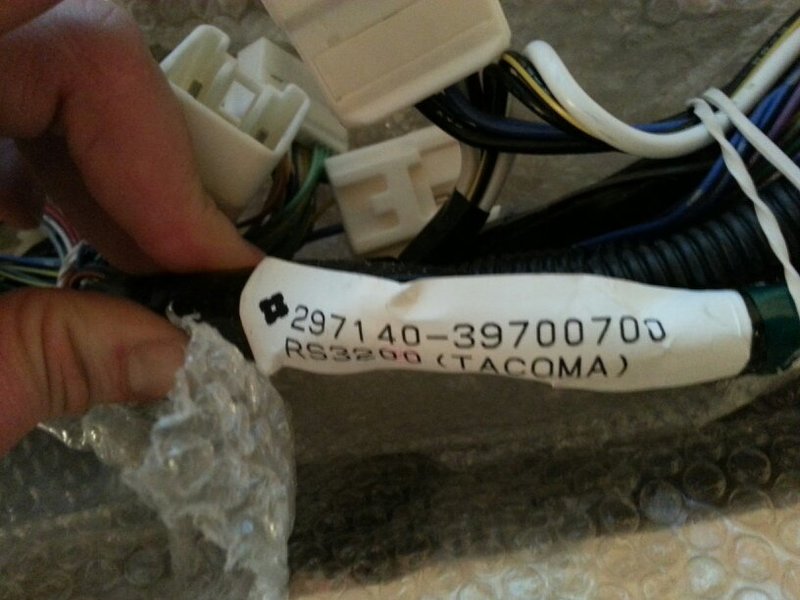

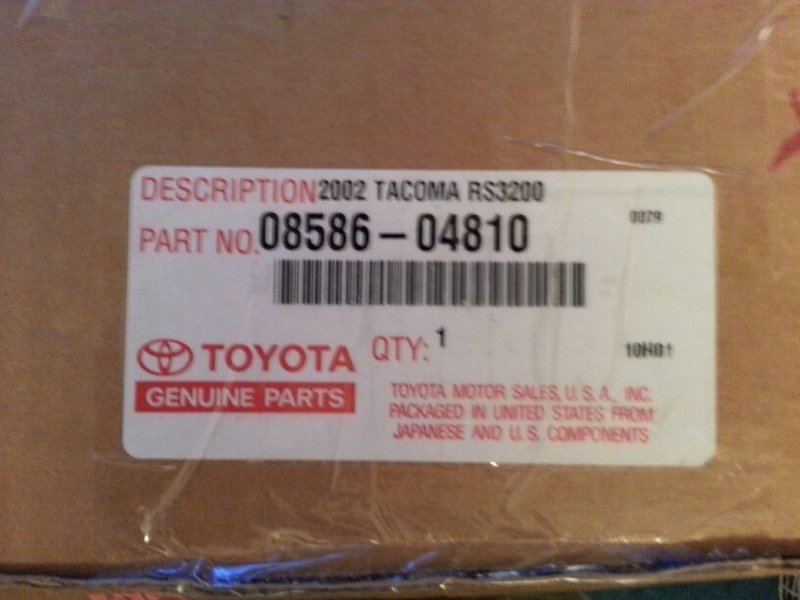

    Got the kit. Seems legit. I dont really know how to tell if its for sure the right one for the 02 until I go to installing it...I figure I'll try to match it up to what the official installation docs show though before I go tearing the dash apart. Ive already read over the install docs and the install really doesnt look too bad.
    Heres a couple pics. There is a sticker with a part numberish looking number on the wire harness...but its a bit too long...maybe dropping off the last few (3?) numbers makes it legit...? But then i think the first number is too long still? Toyota part numbers are 12345-12345, iirc. Thoughts?
    Sticker says:
    297140-39700700
    RS3200 (Tacoma)

    Thanks!
    Good luck with the install. From what I've read, you're going to need the "Base Kit (08585-33830)" along with the install kit that you already have. The base kit is still available...Not cheap.
