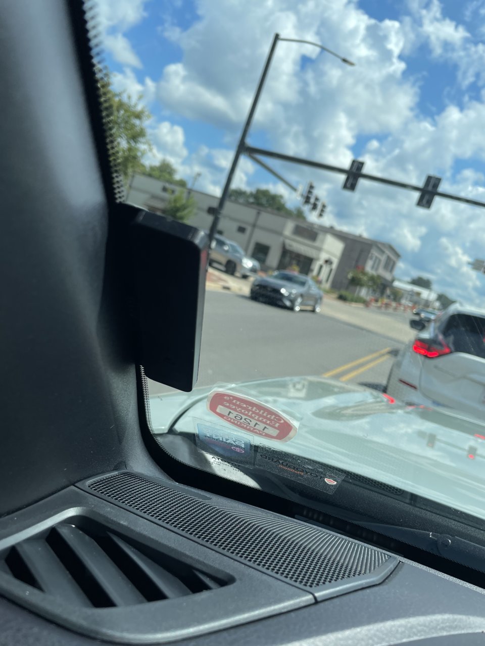

    Yep I'm trying to rip mine out, apparently though you can lock the truck with the keys in it with this.

    Does it block the windshield enough that you want to tear it out? Apparently, it can be mounted remotely. I thought about mounting it to the back of the cab. :notsure:

    I don’t like it. Maybe I’m ocd.

    Yup. Adding that, plus KTJO grab handle, and Heads Up Display, that corner will be too busy for me. Thanks for the picture! I'll be installing it on the rear window:

    I have to keep the childrens hospital sticker there for work, security is nazis, but the other stickers coming off. I don’t know what I’m gonna do with it either leave it or just pull the main piece or disconnect the harness and leave the wiring in the pillar. Back definitely will be better.
