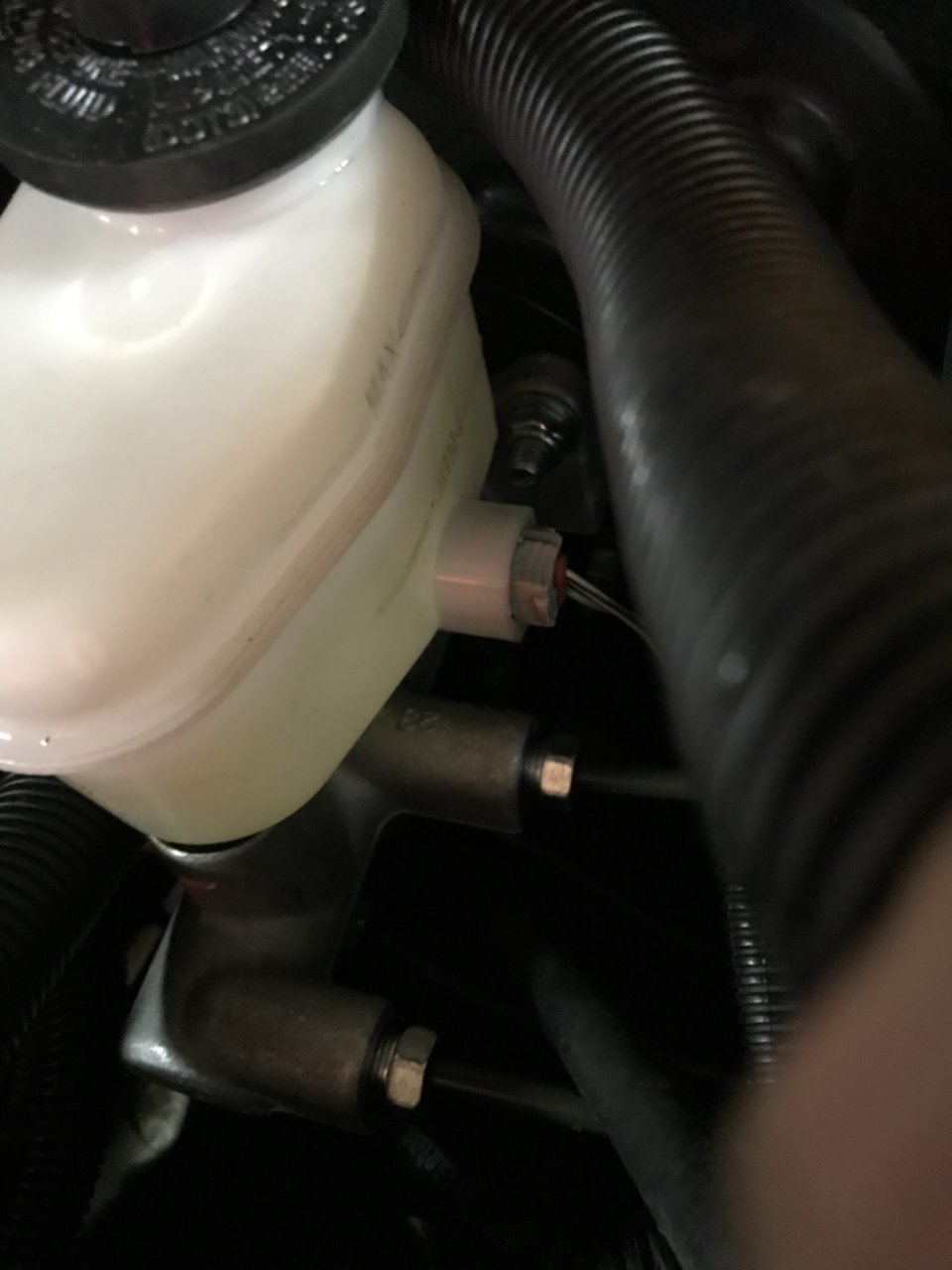

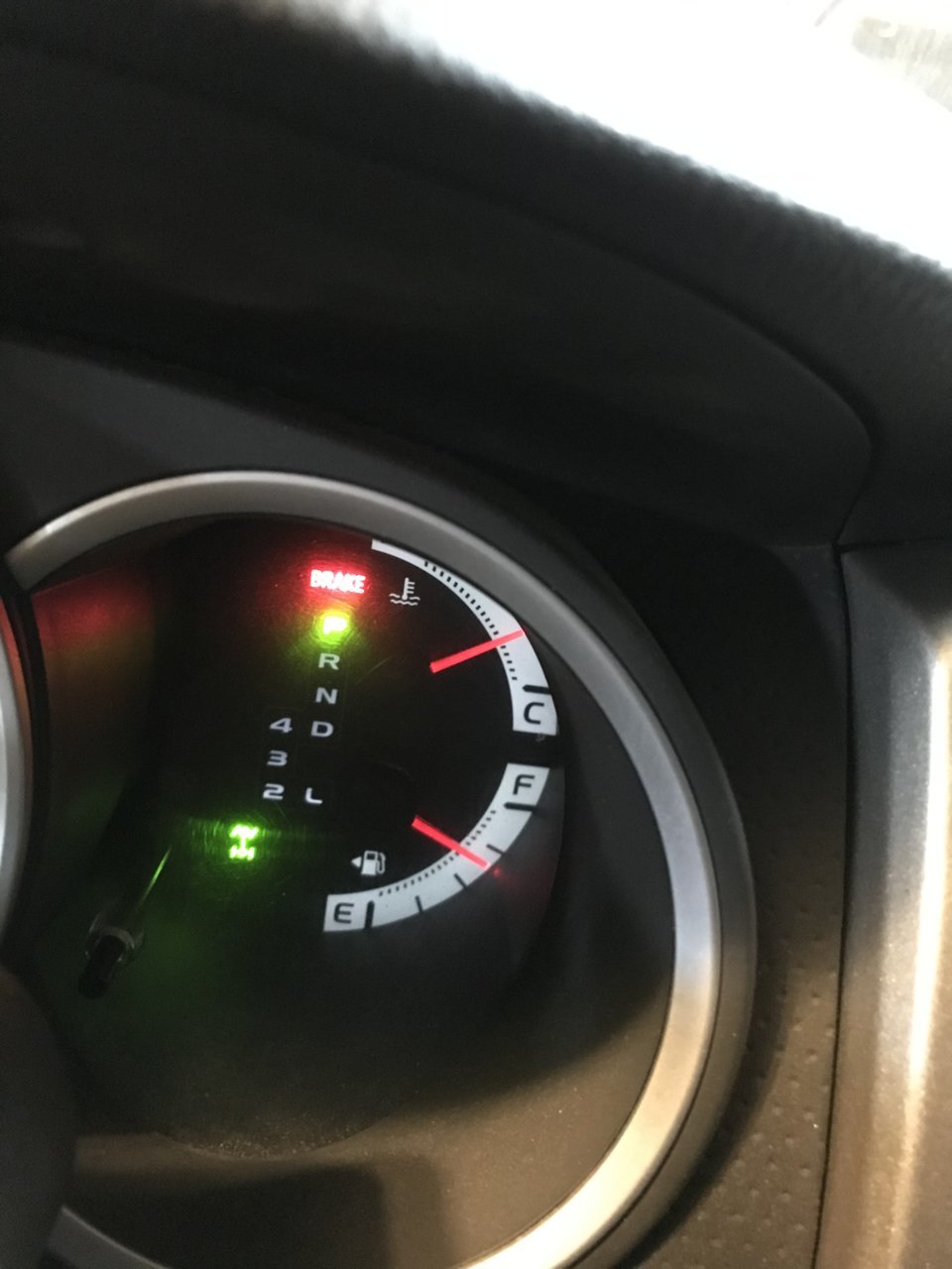

    So here’s a weird one.
    I put a Sequoia Master Cylinder in my truck due to putting discs in the rear.
    I actually did it twice... the instructions are terrible. I had the pushrod adjusted a little too long on the first go round. I spoke with @Hawk373 who had done this install previously, and he got me straightened out. The brakes are working great now.
    The problem is, that the light that normally lights up when the parking brake is on, is on.
    If I unplug the low level sensor on the MC reservoir, the light goes out. If I plug it back in, the light comes back on. This seems to be the exact opposite of what should be happening...
    The rear disc brake kit does not have a parking brake, so I can just leave the plug unplugged, but I’d like to know WHY this is happening.

    It’s obviously activated by the parking brake pedal AND the low level sensor.
    Seems the problem is at the sensor, not the parking brake.
    I should’ve unplugged the sensor, then pushed the parking brake pedal to see if the light came on.
    Tomorrow.
