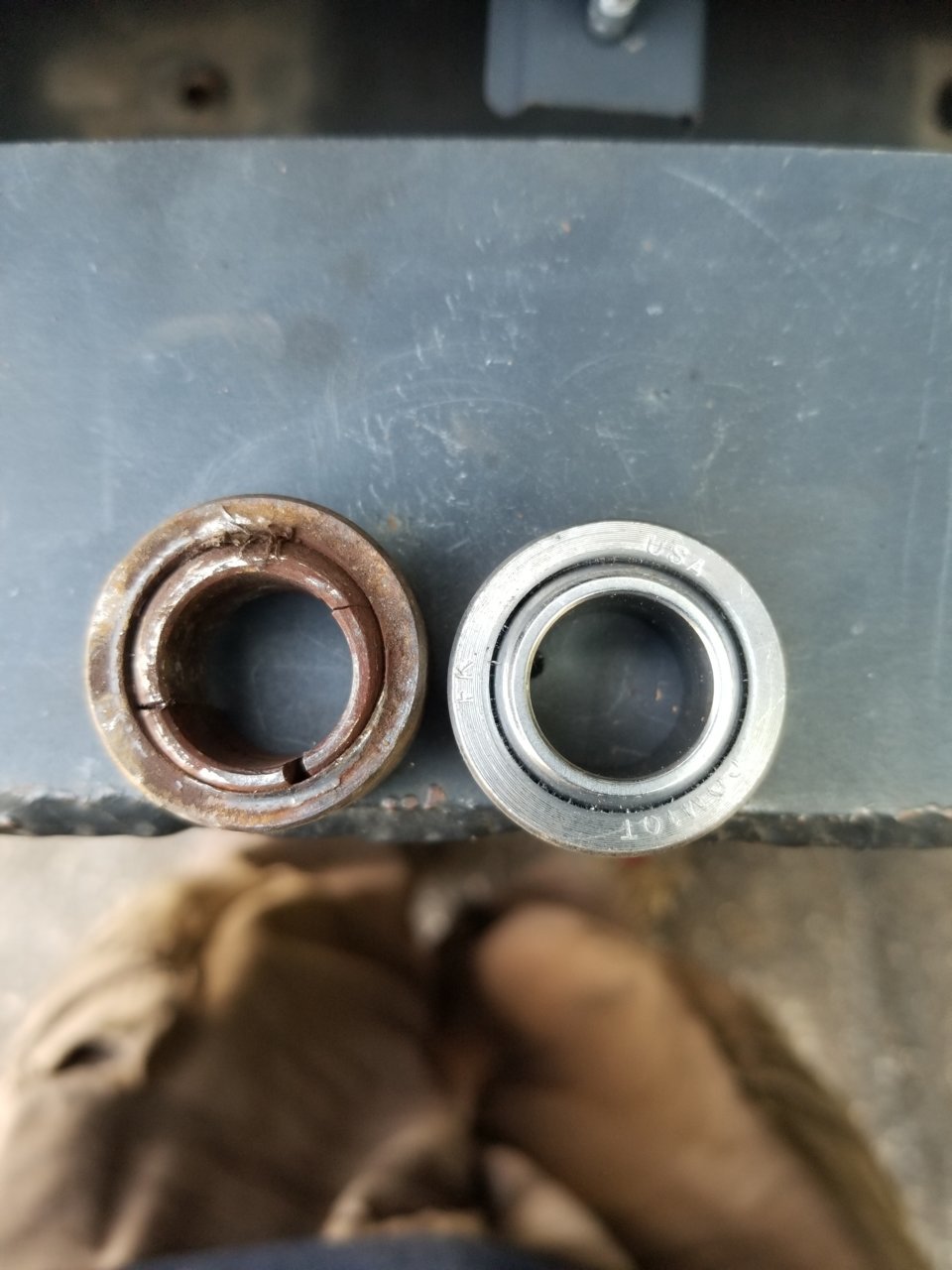

    Very easy on the truck, but they do need to be pressed in. What I did was use a ball joint press kit, and a 21mm socket was the perfect size to push them in and out. Doesn't require much force, but too much to just push them in by hand.

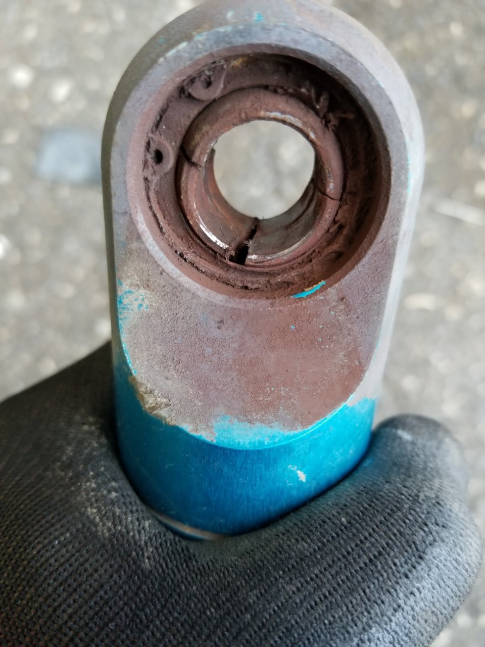

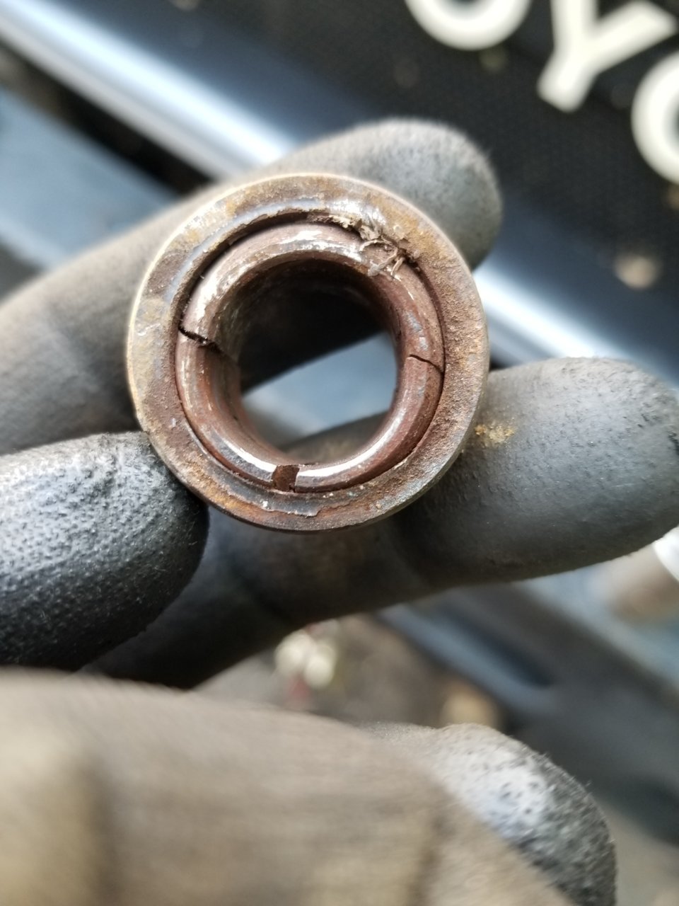

    I took them off. Not hard.
    Getting them out was way harder. Used a shop press. 19mm or 22mm fits exactly in the eyelet and will push the whole bearing out. The first side undid, I was only pushing on the misalignment, hoping it would work. It didn't. Ended up pushing out just the inner part, left the race behind. Used a bigger socket and all was great.
    Going back in, the same socket to get em out and a mallet. Anti seize ev err ree thang
    I'd say this would be a bigger pain in the ass to do on the truck, honestly.

    No problem. If you go that route, this will be the one time I recommend using a hand tool over ugga dugga’s, since it really requires minimal force. Gives more control and easy to get it perfect.

    I did some danger close stuff with A-10’s back in 1993. Could feel those rounds hitting the target.
    Damn. How does that happen? Did you call King about it.

    Not sure how it happened. I bought these King's second hand and I don't know how beat they were by the previous owner. Maybe he beat them like I do? I don't baby my truck at all, so I'm thinking it's just normal wear and tear combined with winter weather and being the type of joint it is.
