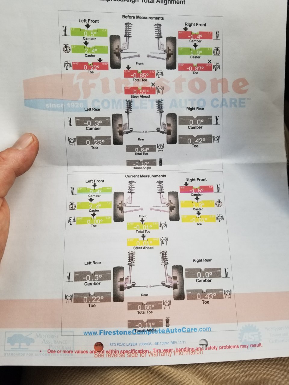

    I knocked the fuck out of my alignment, and turns out they can't align it, because my pass side bolts are "frozen".
    Fuck!

    Alignment guy says that I need new bolts and bushings, or new control arm (pass side). From what I heard around here, might be easier to change the whole arm instead just bushings
    Waiting for an estimate, we'll see.

    It is. I changed the bushings and it did not go well. Lots of fire, beers, choice words, and metal shavings. You're a 3rd gen though...that seems kind of early to be seized up.

    That sucks. New control arms is easiest. I changed the bushings myself in a spare set I bought. It was a pain in the ass. I'm glad I bought a spare set as it would have taken my truck out of commission for a while.

    On the other hand, I must have done it a little bit ago. Bad camber is wearing out inside of my pass side tire.
    Yeah well, less than 34K on it, I'm a bit surprised and not way happy about it. But from what I understand, some 3rd genners had issues like that as well (I've been staying out of 3rd Gen forum, so I'm not up to date with all of it though). Nonetheless, I might have waited too long between wheeling and alignments (this was first one since June last year), or just shitty luck.
    Anyways, I'll have to look up some prices, and start ordering.
    What's general consensus on LCA, go stock, right? Not NAPA or equivalent
