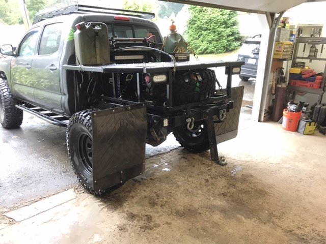

    I’m not sure. You guys would know better than me on that.
    From what I’ve been told, it depends on the County whether they do a sniff test or not. If it’s a county that they don’t, there is an O2 SIM built into the UCON, so there are no CELs.
    If you need to pass a visual, I was told that the resonators in the Y-pipe are Cat-ish enough looking for some guys. If not, you could easily weld hollow cats in their place.
    I also have the factory manifolds. They can go back on in place of the headers, put a 2.85” pulley back on, and go down to a stage 2 tune, and that will definitely take care of emissions. And still have plenty of power.
    I made removable mud flaps for the rear out of semi truck flaps. And I guess you’d need some sort of flares for the front fenders.
    Am I missing anything?

    Cool. So not really a big project to get it to pass then.
    I also have a set of baby tires for it. That might help too...

    I'm not sure if your rear would pass fender wise tbh. Depends on the cop, who will also pull people over for tire poke if they have PA plates.
    Ditch lights also technically need to be covered to pass inspection and cops can be wankers if they want to be.
    What would be the point of buying that truck and not running 37s?!
    I can't tell but what's the height on the rear bumper?
    Edit: I think I'm the one that actually answered the smog question last time. It's mainly the big cities that sniff.

    I don’t know. I’d have to measure later. It’s pretty high.

    It would also be pretty easy to make a new “bumper” that slipped into the receiver.
    With the hundreds of hours of work that have gone into this truck, all of this seems pretty simple to me lol.

    It's more the bed itself. It might need a modified title...as ridiculous as that sounds. A buddy of mine tried to replace the bed of his truck with a wooden one and they wouldn't inspect it. He tried several places as well. Maybe he didn't find the right place yet.
    http://www.dot.state.pa.us/Public/DVSPubsForms/BMV/BMV Fact Sheets/Modified_Vehicle.pdf

    I wasn't sure if that'd be a problem or not, the only people I know who have flat beds know "a guy"

    Yeah, I have no idea. If it goes to PA with me, it’s getting parted out.
