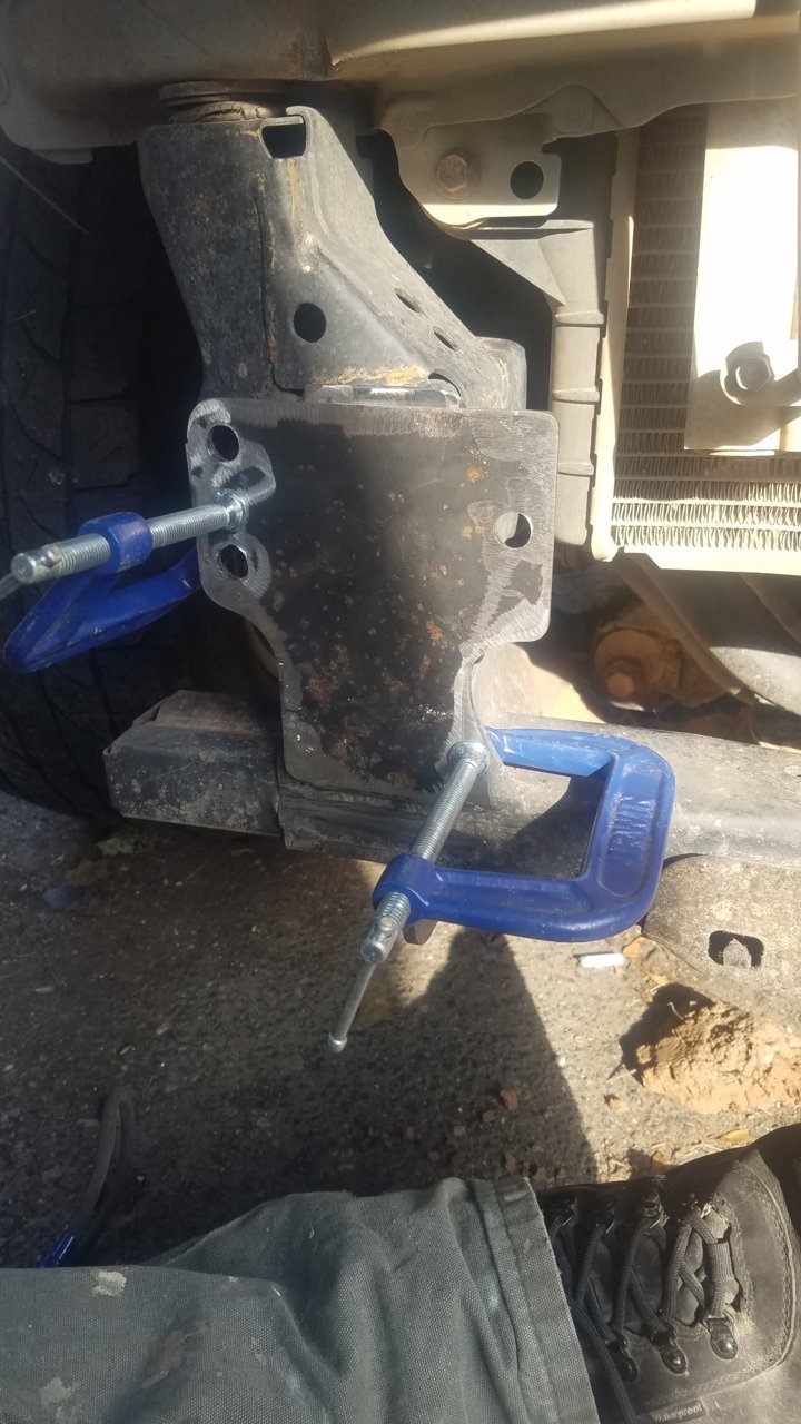

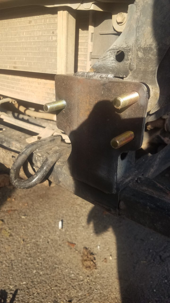

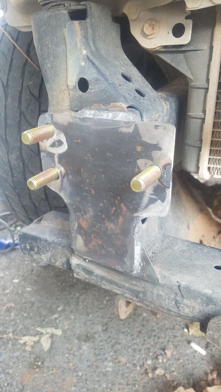

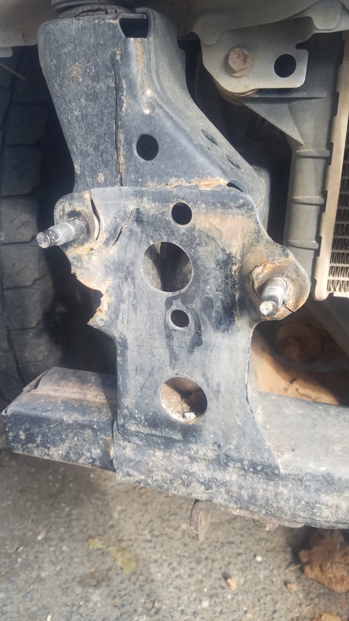

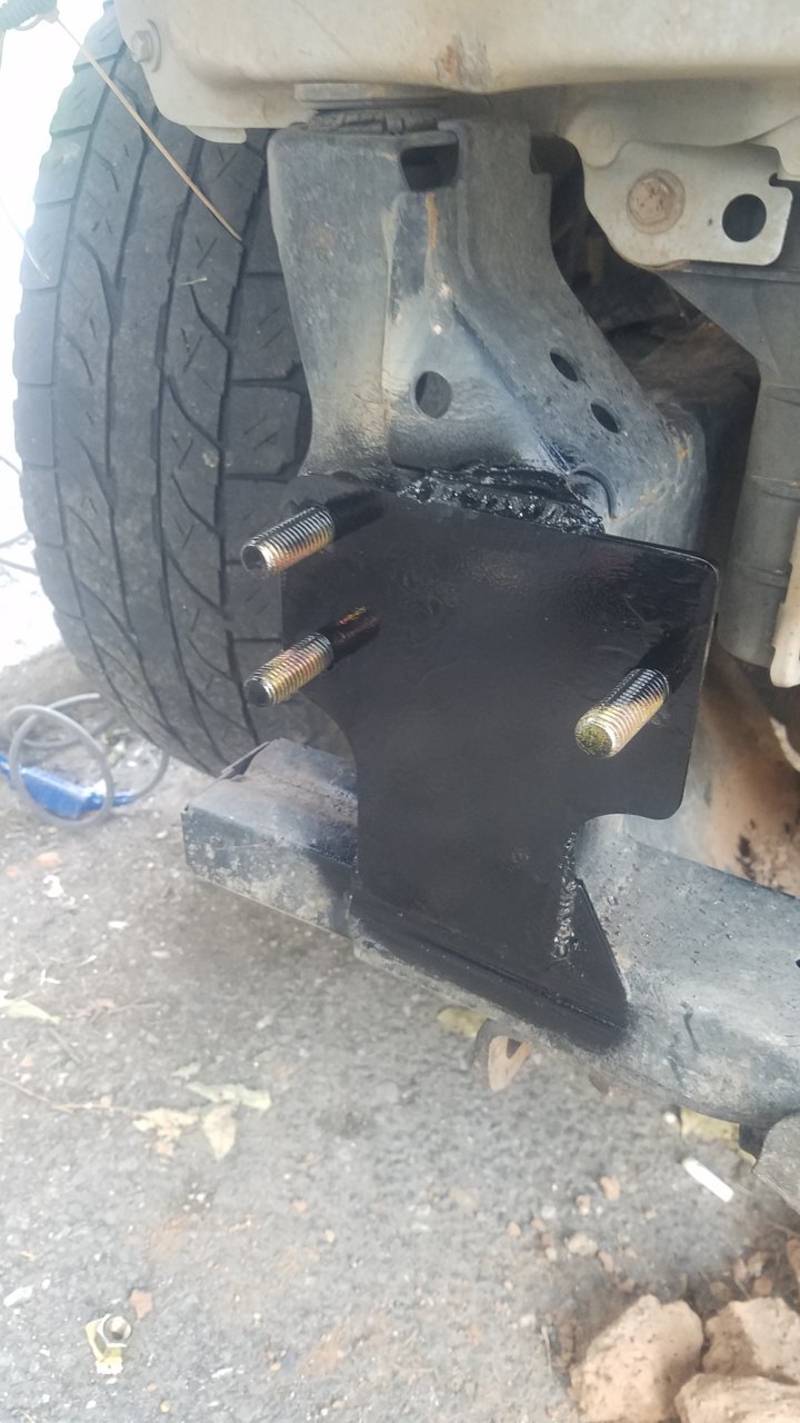

    This was condition of paper thin mounting points after removing bumper. Six bolts - three on each side.

    time to weld a plate in there instead of 1/16 metal. You would really expect an aftermarket steel bumper to be built better than that. I would at least.

    That was back in 2017. Plates have long since been added.20180711_181836.jpg 20180711_182449.jpg

    Bumper was fine, that's the stock attachment point that failed. BAMF makes one style of frame tie in, while ARB makes use of a second style. Both are intended to increase the absolute failure point of the bumper to the actual structural steel.
