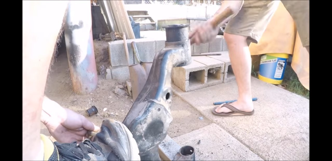

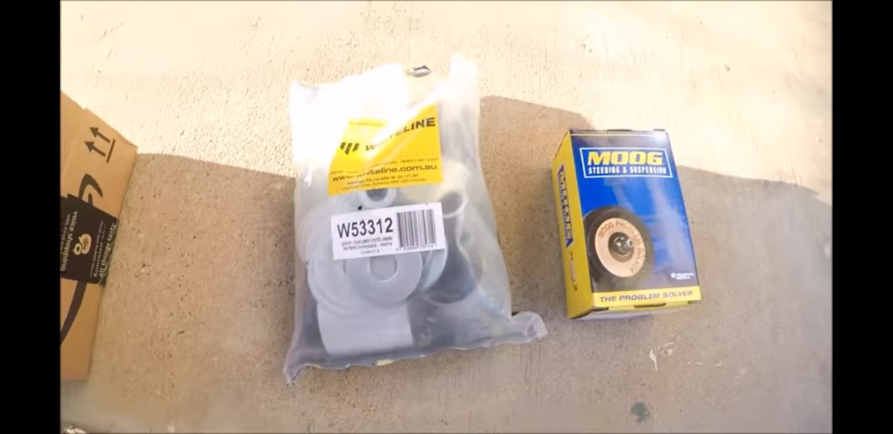

    I don't have to reuse the oem outer sleeves if you use the Hilux bushing kit as they come with new outer sleeves. Just wat hed this video and I'm not sure I want to go through all that work, I've done bushings, sleeves, etc... slot in the past on other vehicles but it's never fun.
    https://www.youtube.com/watch?v=dKO5cmMHus0&feature=share

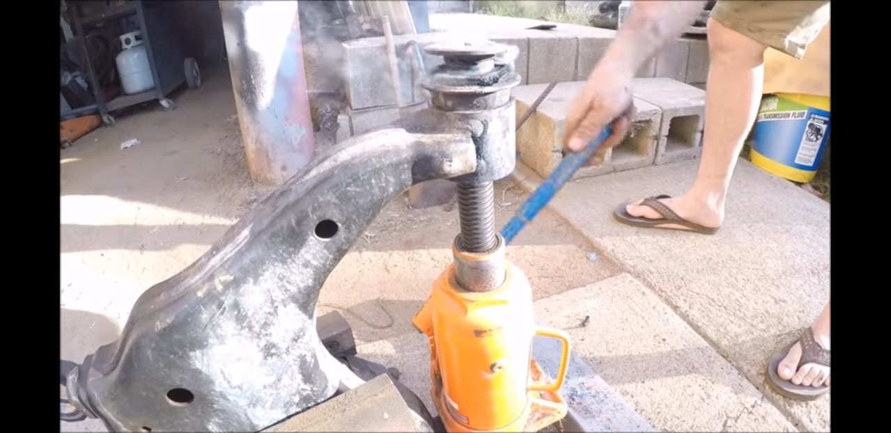

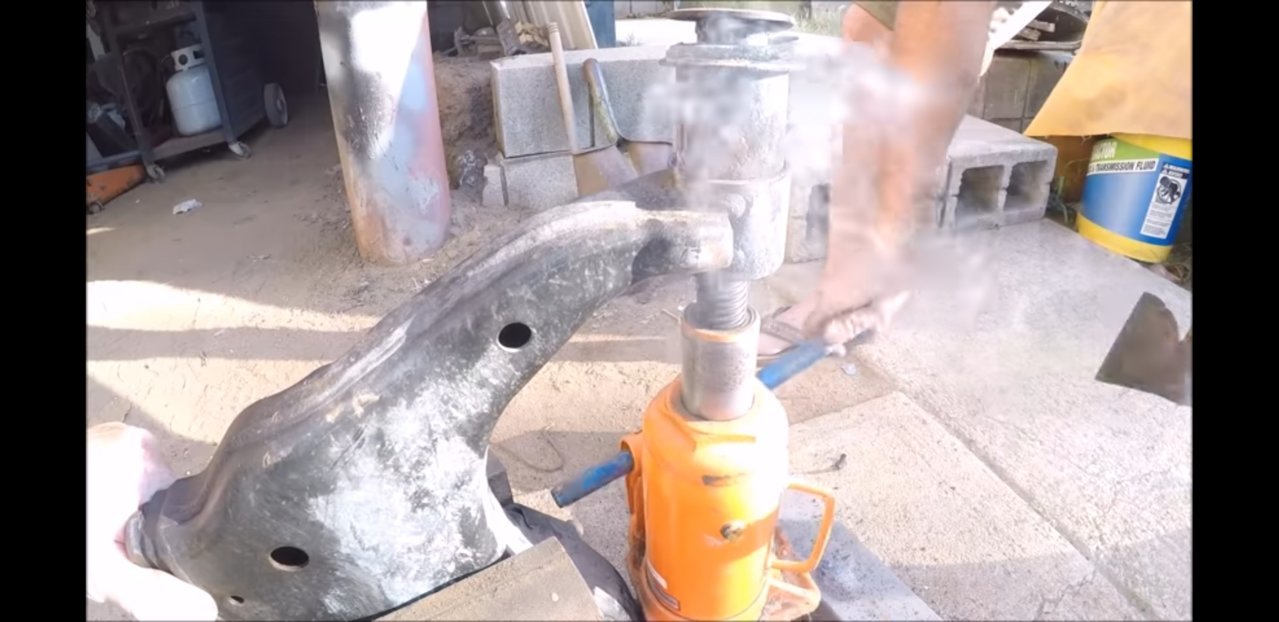

    In the video you can see him burn out the old bushing, then use a huge press to press the whitelines into the oem sleeve, and then that whole thing goes back into the LCA. Im not doing that. A 20lb press cant do it, you need bigger. And on top of that you need to grease them yearly.

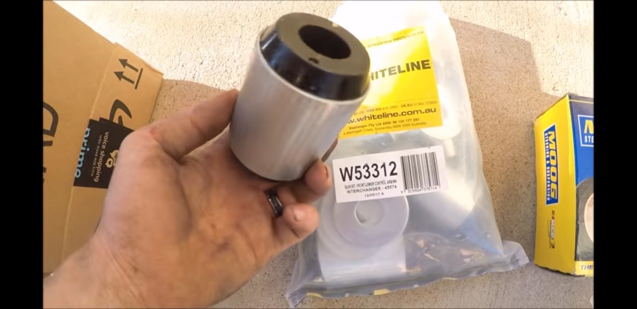

    He removed both outer sleeves. LOL but yes it is a pita to press the new bushings in. I've done this many times with my hf balljoint press kit and a hf electric impact gun. You can see he pressed out the complete old bushings and outer sleeves. On the last one he pressed out the bushing then had to get the sleeve separate.
    Screenshot_20200227-125256_YouTube.jpg Screenshot_20200227-130007_YouTube.jpg
    Here's the Hilux bushings with the outer sleeves already on it from whiteline.
